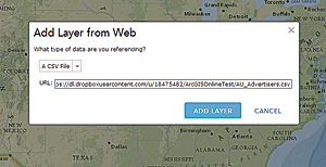

Adding CSV Files
This link points directly to the file stored in the Dropbox cloud, so it can also be used for adding locations from spreadsheets to your maps as well as photos to your pop-ups. You can use Dropbox public links to add locations from CSV files directly to your map by clicking Add, then Add Layer from Web. Then choose a CSV File from the drop-down list, paste the Dropbox public link in the dialog box, then click ADD LAYER.

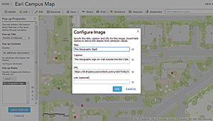

Use an image you have in Dropbox in a map pop-up by copying the public link as the URL when configuring the image.

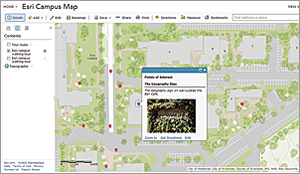

The linked image residing in Dropbox is displayed in a pop-up.

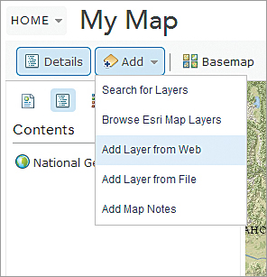

Add locations from a CSV file in Dropbox directly to your map by clicking Add, then Add Layer from Web
Add the CSV file using the Dropbox public link.
