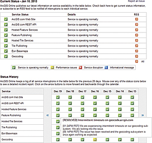

You and your users can monitor the health of the ArcGIS Online system using the ArcGIS Online Health Dashboard to keep abreast of any changes that might impact your work. This dashboard provides the latest information on the status of services, both current and historical. Messages indicate whether services are performing normally, have performance issues, or are disrupted. Hovering over the symbol for each state will give you more information on the service's state.
