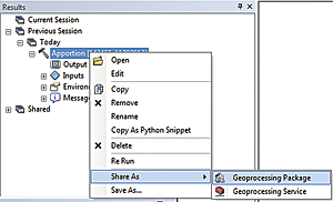

Create a geoprocessing package by simply right-clicking the results of a process in the Results window and choosing Share As > Geoprocessing Package.

Creating geoprocessing packages is simple and straightforward. Make sure the process runs correctly, right-click the result in the Results window, and choose Share As > Geoprocessing Package. You can add additional files, such as Word or PDF files, but not executable files. You can check Include Enterprise Geodatabase data instead of referencing so any related data residing in an enterprise geodatabase will be converted to a file geodatabase and included in the package. The option Support ArcGIS Runtime will only appear if you previously enabled this support by choosing Customize > ArcMap Options in the ArcMap Standard menu. Use the Add Result button if you wish to add another result to the package.

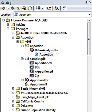

Unpacked geoprocessing packages appear on the Shared node in the Results window. The package file itself resides on your ArcGIS user folder.

Packages are not only easy to create but easy to use. They are supported in all ArcGIS applications. Unpacked geoprocessing packages will automatically show up in the Results window under the Shared node in ArcCatalog or the Catalog window in ArcMap. Like all package files, by default, the file itself is actually stored in C:\users\<username>\My Documents\ArcGIS\Packages (for Vista and Windows 7 users) and C:\Documents and Settings<username>\My Documents\ArcGIS\Packages (for Windows XP users). ArcGIS recognizes a geoprocessing package by its checksum and won't download and unpack the same package multiple times to the same location.

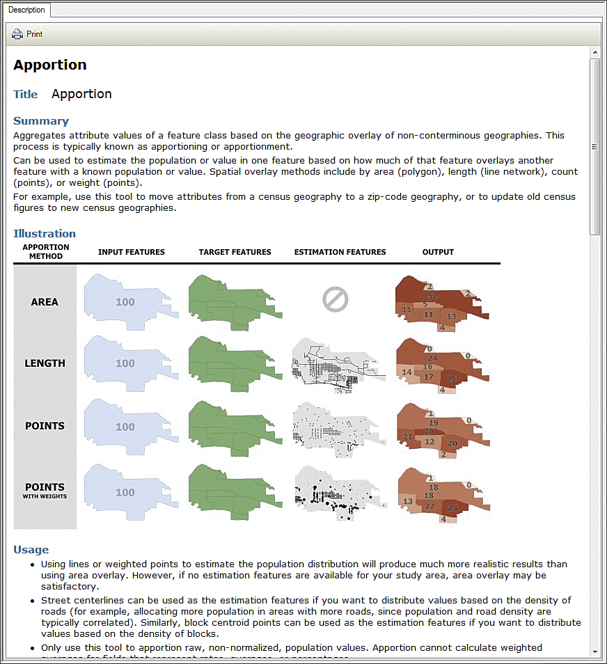

ArcGIS requires a minimal level of documentation when packaging a result, but the minimum may not be sufficient if you are sharing this package with a wider audience, particularly if you are uploading it to ArcGIS Online. The quality of your documentation will be better if you write it before starting the packaging process.
System tools are already documented, but if the package is based on results from a custom tool, you will have to supply that documentation. Document a custom model or script tool in ArcMap by right-clicking it in the Catalog window or the ArcToolbox window and selecting Item Description. In the Item Description window, click Edit and add tags and the summary for the tool (the minimum requirement). Under the Syntax section, expand each parameter and make sure Dialog Explanation is populated. It's a good idea to add any credit or usage information or code samples that will make the tool more useful to someone unfamiliar with it. When finished, click Save. Note that adding labels to ModelBuilder models or comments to Python code will make them more understandable.
In addition to documenting the tools that created the result, you need to document the package itself. Do this in your favorite text editor beforehand and copy and paste it into the package description text box.
