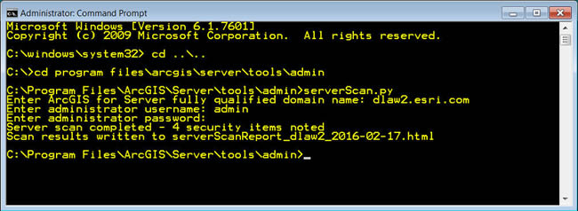

Step 4: After you enter the last parameter, hit return and the serverScan.py tool will run.
Administrator: Command Prompt
The serverScan.py tool generates a report written in HTML format. By default, the report will be named serverScanReport_<machinename>_<dategenerated> and will be stored at the same location as where the tool is executed—in this case, within the admin folder.

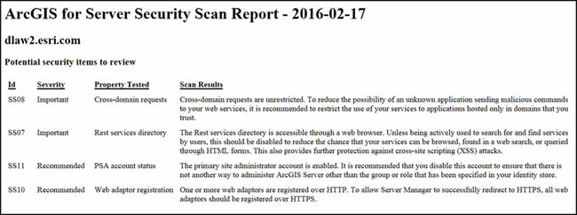

Sample security scan report
Notice that each reported item has a unique ID, is categorized based on the severity of the issue, and includes a name and description. The report recommends some parameter settings you can set and/or adjust in your ArcGIS Server site so that you can make it more secure.
Step 7: Review the report results and check them against the ArcGIS for Server online help topic Scan ArcGIS Server for security best practices.
This help topic describes each of the 12 different Esri security best practices for an ArcGIS Server site. You have the option to apply all, some, or none of these to your site. The more best practices you apply, the more secure your ArcGIS Server site will be.
