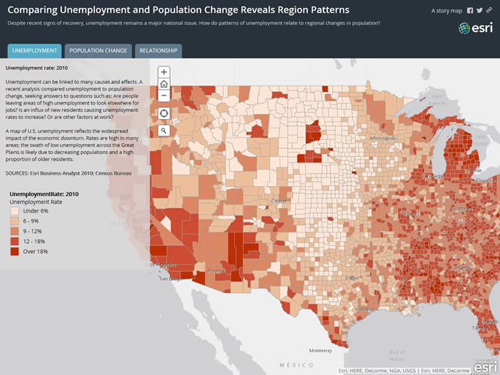

The following Story Map Series app (using the tabbed layout) looks at unemployment by presenting three maps: unemployment rate, population change, and an analysis of the correlation between the two.

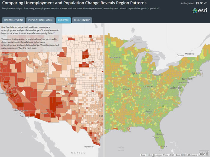

The modified version (shown below) of the same story map inserts a Story Map Swipe application at the third tab, allowing a visual comparison of unemployment and population prior to the final analysis map. The Story Map Swipe application was added using the &embed URL parameter discussed earlier.

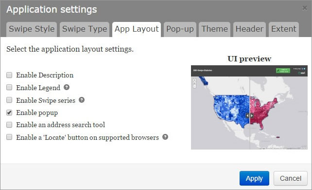

Begin by authoring Story Map Swipe and Spyglass apps using the desired maps or layers. The Swipe and Spyglass layout options work equally well. For the purposes of embedding, it is best to leave all App Layout settings unchecked, except for Enable Popup (if one is desired).

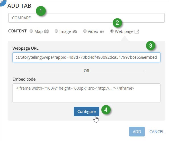

Embed Story Map Swipe and Spyglass Apps in a Story Map Series
To embed Story Map Swipe and Spyglass in a Story Map Series app (as shown in the example above), follow the steps below:
  1. Add a new tab, entry, or bullet (depending on the layout chosen) and enter a title.
  2. Choose Web page.
  3. Copy and paste the Story Map Swipe and Spyglass URL, and make sure &embed is appended.
  4. Click Configure.
  5. Choose Stretch (the app will not distort).
  6. Click Add and complete the tab, entry, or bullet.

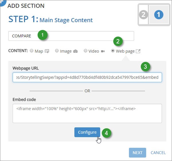

Embed a Story Map Swipe and Spyglass in a Story Map Journal App
To embed Story Map Swipe and Story Map Spyglass in a Story Map Journal app, follow the steps below:
  1. Add a new Section and, in the Main Stage Content, enter a title.
  2. Choose Web page.

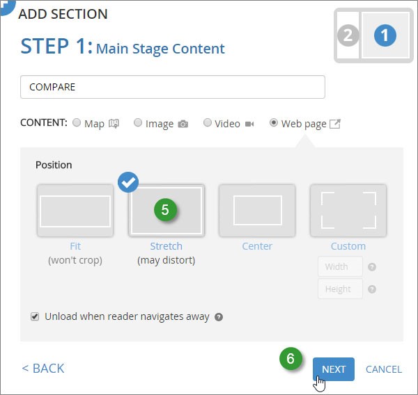

  4. Click Configure.
  6. Click NEXT to complete the new section.
