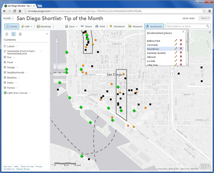

In the map, click the Bookmarks tool and select Downtown.
the Bookmarks tool, where to select Downtown

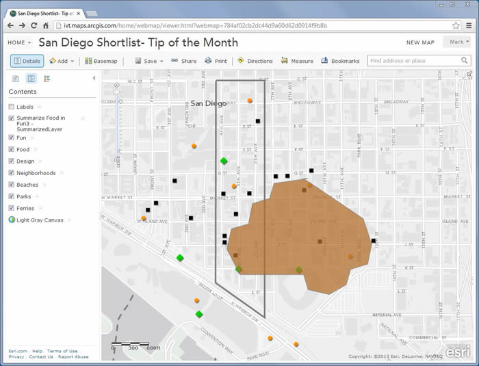

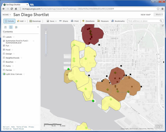

Click the Run Analysis button on the bottom of the analysis dialog box. When it's complete, you'll see a new layer in the map with the results showing .15-mile drive times from the Food and Fun layers. The polygons are color coded by the total number of restaurants that fall within each area. Dark colors have more restaurants, and light colors have fewer. It should look similar to what's in the screen shot below:
results of your Run Analysis

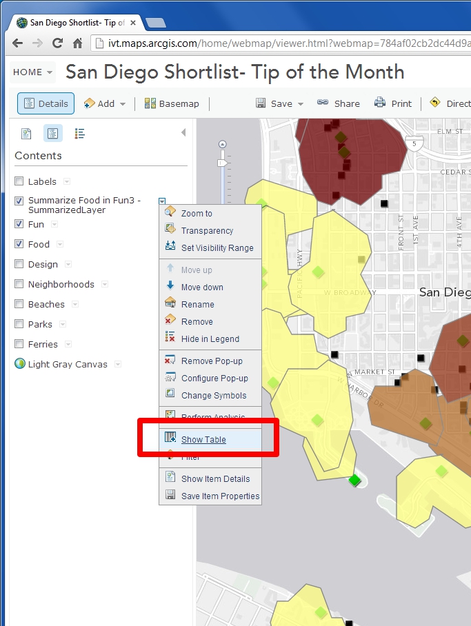

Next, in the table of contents, click the arrow next to your results layer and select Show Table. The table should open at the bottom of the map.
the Show Table selection

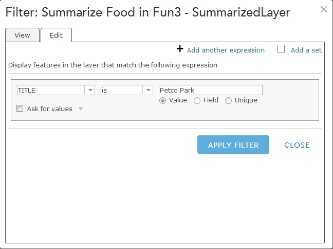

In the table window on the far right, click the Table Options drop-down arrow and select Filter:
Change the filter with the expression TITLE is Petco Park and click the blue APPLY FILTER button:
the Apply Filter button

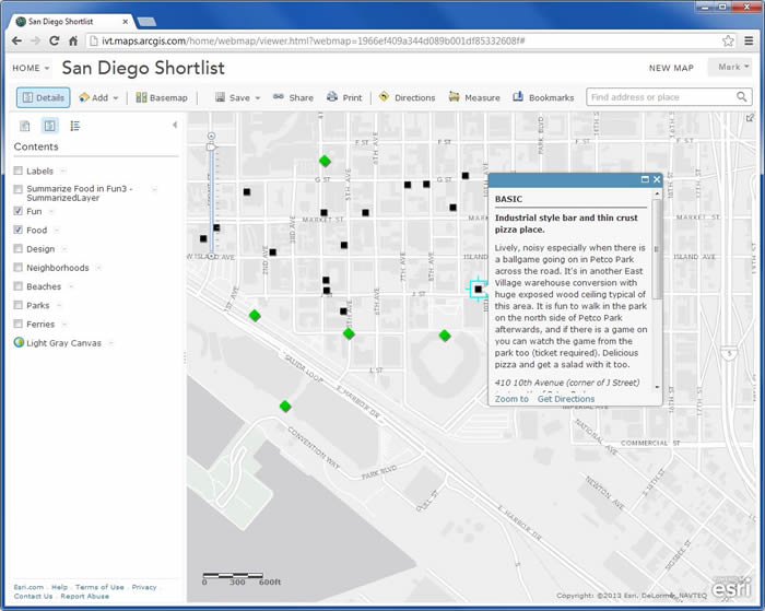

Now simply click the black points representing restaurants to identify each one. After clicking the black dots and reading the descriptions of the restaurants in the pop-up window, it looks like the restaurant BASIC on 10th Avenue and J Street, which specializes in thin crust pizza, would be a good option given its liveliness and proximity to Petco Park.
click on the black points to identify each one
