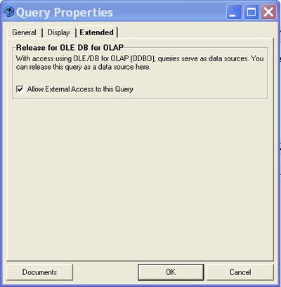

Does the OLAP for ArcGIS add-on support queries from SAP BW?
Yes. To visualize queries from SAP BW, you must check the Allow External Access to this Query option for your SAP query on the Extended tab (on the Query Properties dialog box) in the SAP Query Designer Tool.
