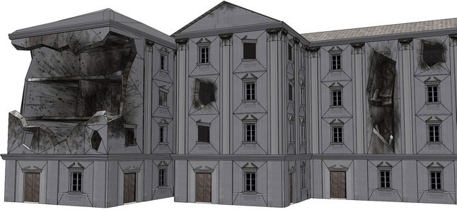

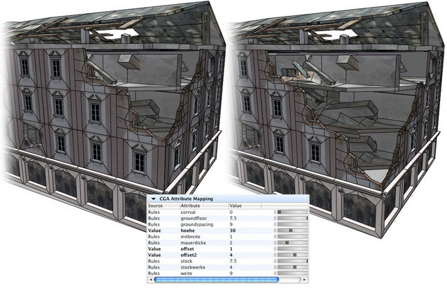

It was clear that the particular environment Holzer and his team wanted to achieve needed a large central European city with a low polygon count that would be created in a short amount of time. In addition, they called for an efficient way to model the destruction, since over 60 percent of the city should show some, if not total destruction. Holzer was able to use the CGA shape grammar in a way that allowed him to implement the destruction of the architecture procedurally.

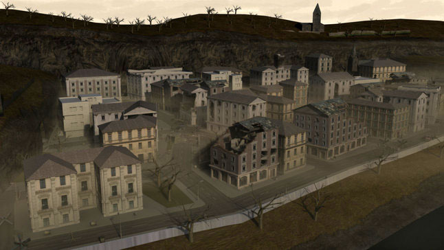

  6. City model exported from CityEngine as FBX® format, using merge by materials. Model imported to Maya® for fine tuning (see image).
CityEngine was used to generate the entire game level along with distributing all assets. The parametric destruction of buildings was also implemented using CGA rules written in CityEngine. The final game level was eventually exported from Maya® to use with the Ogre3D-Engine.
