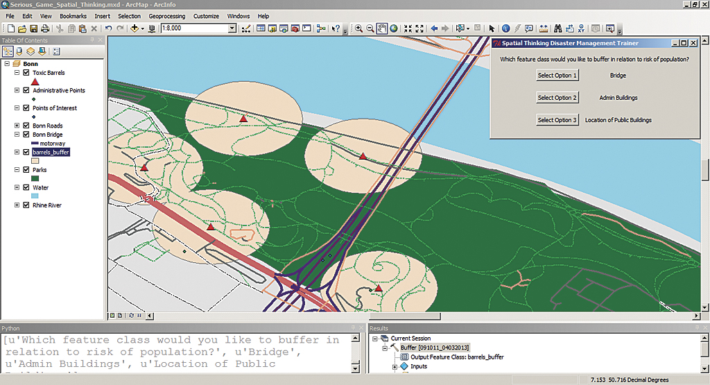

Pressing the button for Option 2 runs the underlying Python code, uses ArcMap functions, creates a 500-foot buffer around the toxic waste barrels, and updates the map. Next, the player is presented with options for determining risk to populations using buffers.

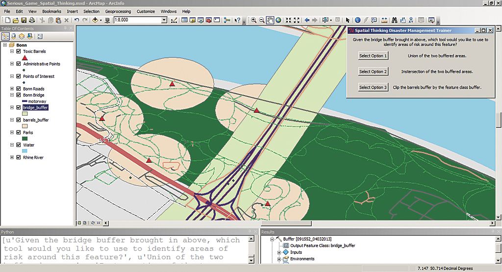

The options available to the player are adjusted based on the initial choice. Selecting Option 1 creates a buffer around the bridge. The question prompt asks the player to choose a geoprocessing tool to identify risk areas in relation to the bridge buffer that was previously selected. The player is now presented with one last set of options.

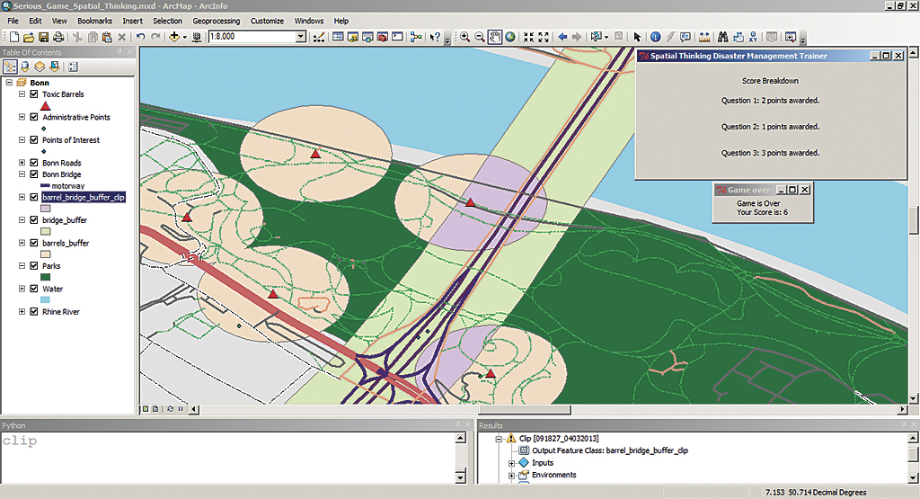

Upon completion of the game, the points for each question are added to present the user with an overall score that represents their grasp of the spatial thinking ability required in the game. The program also reports any discrepancies between the user’s selections and the ideal choices and discusses what the user could have done better and why another choice may have been the better option.

Selecting Option 3 clips the buffer around the bridge and the toxic barrel buffer and outputs them, concluding the game. The player's final score is based on the specific choices made during the game. Scores range from 1 for limited spatial thinking to 10 for good spatial thinking ability. A breakdown of points earned for each response is also provided so players can learn to make better choices.
