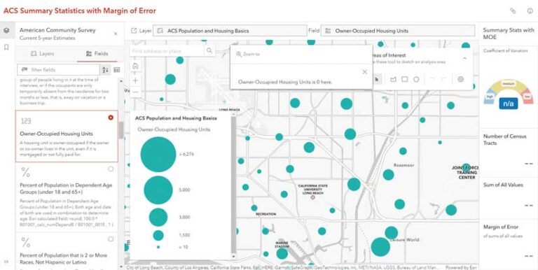

A lightweight app, ACS Summary Statistics with Margin of Error, is available at no charge to help you get a quick sense of how many tracts you’ll need to aggregate to get an estimate that meets your desired level of reliability. The left panel of the app lets you search and select layers and attributes. If you select a count, the tract centroids will be symbolized by size. If you select percentage, the tract centroids will be symbolized by color.
Use the sketch tools on the top of the map to create your super tract. First, draw a shape around the neighborhood or district you know you want to analyze. Get the basic shape on the map to start.

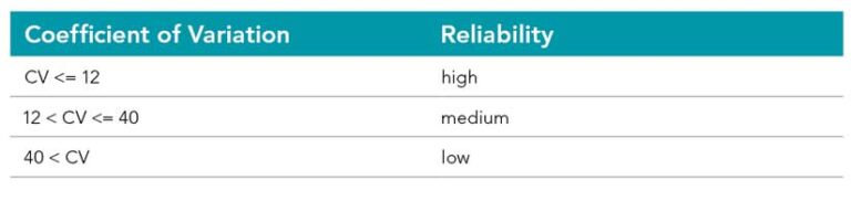

The right panel of the app lets you see summary statistics for the chosen layers and attributes. The gauge shows the coefficient of variation (CV) for the selection, which is calculated on the fly. [CV is a measure of the relative spread of the values.] Watch the gauge change as you modify your sketch. It characterizes the reliability of the CV as high, medium, or low. The lower the CV, the higher the reliability. Conversely, the higher the CV, the lower the reliability.
Reliability for Coefficient of Variation (CV) Ranges
