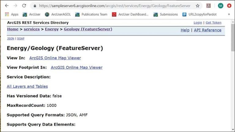

Figure 2: Opening the Geology/Feature Service, which is inside the Energy folder, will add /Energy/Geology/FeatureServer) to the URL.

Look at an example of a RESTful site in figure 1, which shows https://sampleserver6.arcgisonline.com/arcgis/rest/services. If I open the Energy folder in the Service Directory, /Energy gets added to the URL just as it would in Windows Explorer. Inside the Energy folder, I can open Geology (FeatureServer), which will also get added to the URL as Geology/FeatureServer, as shown in figure 2. If I want to work with a specific service layer, such as the Fault layer, the number of the layer (0) will be added to the URL.
Once the URL is pointing to a specific service or service layer, operations you want to perform on that service or layer can be appended to the end of the URL. For example, if you want to query a specific feature by its ObjectID from the Fault (0) layer of the Geology service, you could add the query? operation from the ArcGIS REST API and any parameters for the operation (for example, objectIds=41568). The URL request now looks like this:
https://sampleserver6.arcgisonline.com/arcgis/rest/services/Energy/Geology/FeatureServer/0/query?objectIds=41568
When you send the URL request, SampleServer6 responds to the request with information on feature 41568 in the first layer of the Geology feature service.

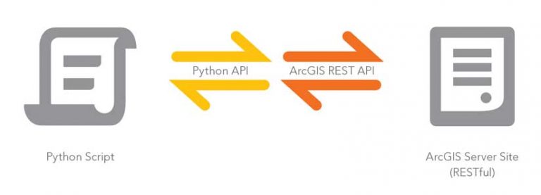

The Python API is the interface between Python scripts and the REST API.

There are two ways to think about this. You can think of the ArcGIS API for Python as the interface between a Python script and the ArcGIS REST API. The ArcGIS REST API then interfaces between the ArcGIS API for Python and the ArcGIS Server site.
What Is the ArcGIS API for Python?
Now that we have dissected Python, Python packages, APIs, and the ArcGIS REST API, we can come up with this final definition.
The ArcGIS API for Python is both an API and a Python package. It includes tools that help a Python script use the ArcGIS REST API, which in turn includes the tools to make requests of ArcGIS Server services. The ArcGIS API for Python helps you write Python scripts to manage your content and users in your Web GIS.
The Python API interfaces between Python scripts and the REST API. Alternatively, you can think of the ArcGIS API for Python as a Pythonic wrapper around the ArcGIS REST API, and both work together as the interface between the script and the ArcGIS Server site.
The ArcGIS API for Python wraps the construction of ArcGIS REST API URLs in Pythonic functions, so instead of having to construct a URL manually in a script, you can call on prebuilt functions that will construct the URLs in the back end.
