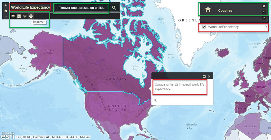

Green boxes show what Esri translates, and red boxes highlight what is driven by web map content. In this example, the web map and data are in English and the browser locale is set to French.

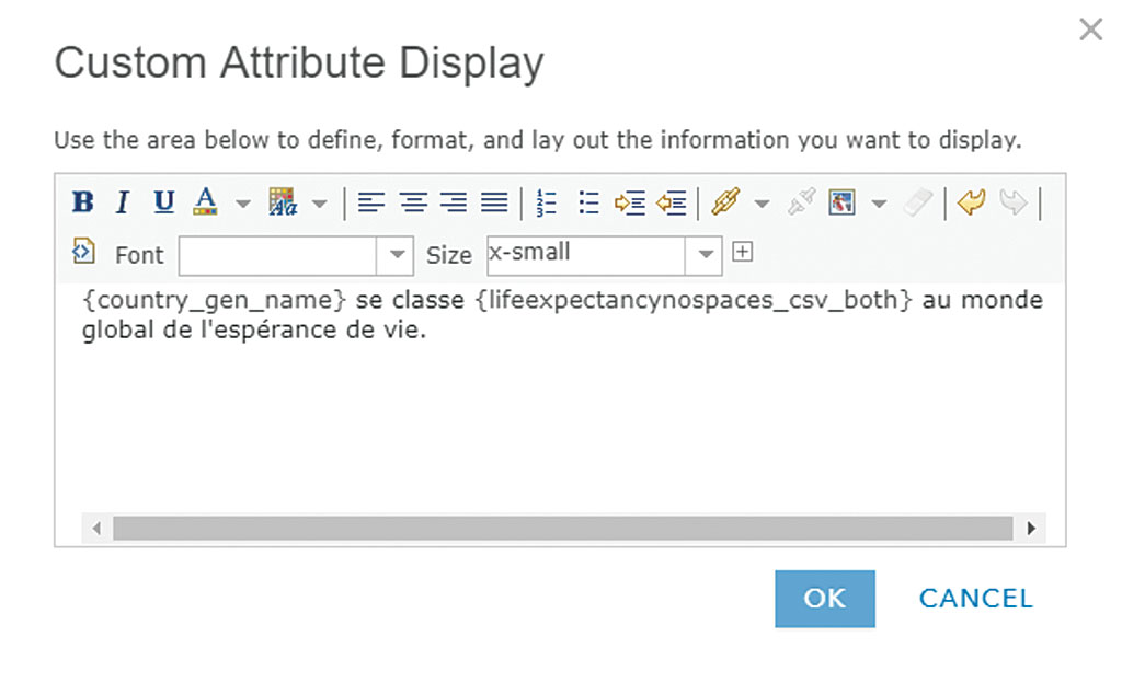

This custom attribute pop-up needed translation.

Start by identifying what Esri translates as part of the localization process and what you will need to handle. Esri handles all application elements, such as search, element labels, and tooltips based on the browser locale or the ArcGIS organization locale. You must translate the web map content. In the example, the web map and data are in English and the browser locale was set to French.

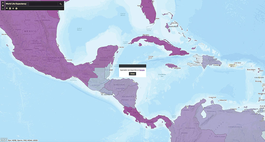

The splash screen links to the version of the app that is in the other language.
The pop-up, app title, and layer titles need to be updated in the French version. Create a second map and update all required data to fully translate your map and app into the language you need.

To enable users to easily choose the appropriate language, I have added a splash screen to both apps. The splash screen linked to the version of the app that is in the other language.
In addition to the splash screen, a URL parameter can be set to force the locale to be in French. In the splash screen hyperlink, a URL parameter can be added to the application URL to force the locale to be set. In this example, “&locale=fr” was added to the end of the French application. For more information, visit the “Use URL parameters to modify maps” topic in the ArcGIS Online help.

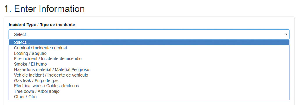

In this example, four fields in the GeoForm app will be used to collect data. One field contains a domain to drive the drop-down options. The domain values appear in both Spanish and English. Having value choices in both Spanish and English will require a bit of planning or updating your data. These domains were created and published from ArcGIS Pro.

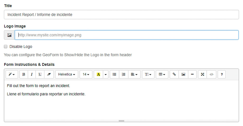

During the configuration process, you can assign a title and short instructions in both languages. In most cases, you should adjust the layer names in the web map, but GeoForm allows you to change the field name labels in the builder. This is a simple way to add a second language to the field name.
