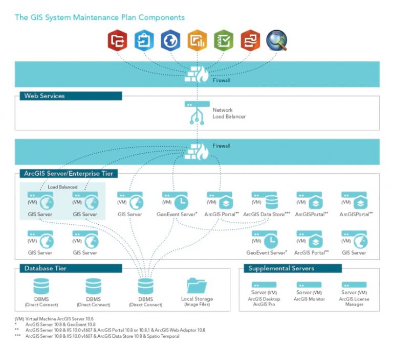

In addition to using ArcGIS Monitor, Wise and Guzi developed a custom tool to generate reports showing the interconnectedness of system components. They call this tool the ArcGIS Enterprise Lineage. Python scripts are used to create combinations of data at regular intervals that are viewed using SQL Server Reporting Services (SSRS). These reports allow team members to reference which system components affect others. For instance, if Wise wants to see every service that uses a feature class from a particular dataset, all he has to do is select the dataset in the report and it generates a list of those services. Instead of relying strictly on inventories, Lineage allows team members to generate dynamic reports that provide an intimate view of the system.
The GIS system consists of databases, ArcGIS Enterprise, GeoEvent Server, supplemental servers, ArcGIS Desktop, Python scripts, and ArcGIS Online.

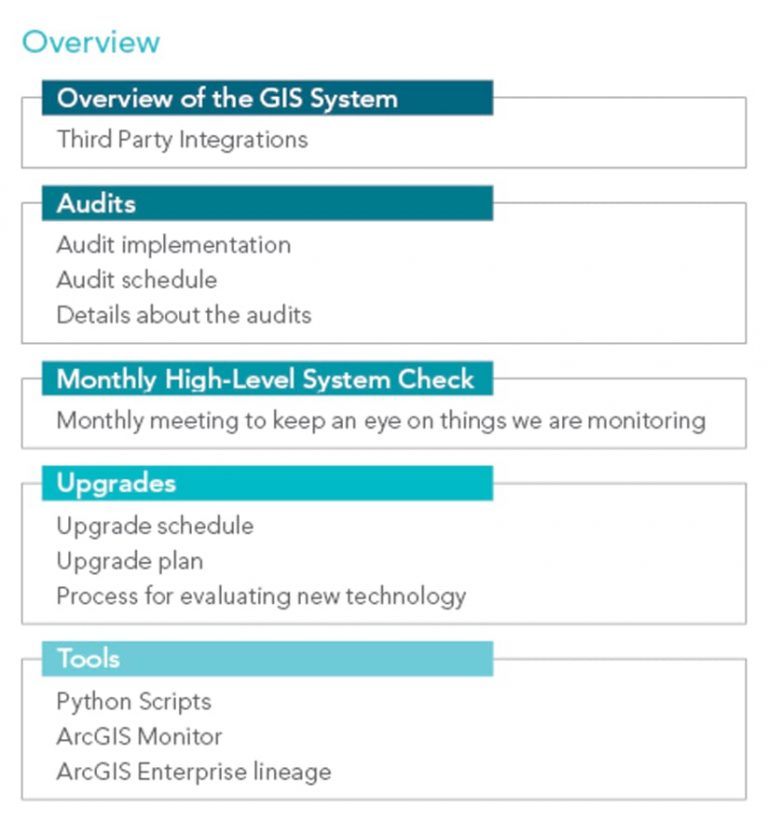

The common thread in each maintenance plan component is documentation. SCGIS uses Confluence—a wiki-esque, web-based software from Atlassian—to document everything about the system, from design to maintenance procedures. Documentation is not only vital to replicating procedures; it also helps mitigate contingencies such as the departure of a team member. If Wise and Guzi were to both leave the department, their documentation could be used by other team members to replicate system maintenance procedures.
No matter the size, all GIS implementations require maintenance. As a system’s size grows, so does the chance of uncertainty. Developing a comprehensive maintenance plan is a necessary measure to ensure system integrity. GIS administrators without a plan don’t need to panic. Wise and Guzi recommend starting with small, achievable goals.
Inventorying system components is a great place to dive in because understanding the structure of a system is important for making good decisions. Once assets are inventoried, brainstorm ways to improve them, such as developing standards. The key here is an iterative approach that allows for gradual improvement over time at a schedule that works for the organization. Asking questions like, What am I missing? or What if this happens? will help change the way administrators view their systems. The plan also doesn’t need to be perfect from the start. The plan and its procedures will evolve as new technology, methods, and other contingencies are introduced.
