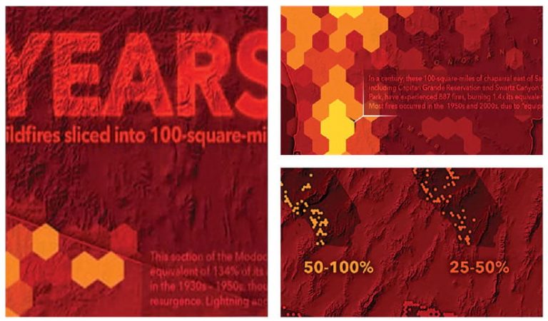

Rather than trying to fit his large and detailed map of California wildfires into a post on Twitter, Esri cartographer John Nelson shared thumbnails.

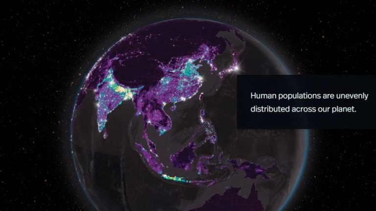

The Human Reach is an ArcGIS StoryMaps story with gorgeous cartography by David Asbury and Cooper Thomas.
4. ArcGIS StoryMaps Is the Best Choice for Interactive and Animated Maps
Given all of these frustrations, ArcGIS StoryMaps is a format designed by cartographers who are all too familiar with the limitations of sharing work online. It will let you coordinate and combine maps, narrative content, and other media. StoryMaps treats maps as a unique type of content, instead of treating maps like photos or videos. ArcGIS StoryMaps stories can handle full-screen maps, 3D scenes, interactivity, and map actions (like zooming in) that are choreographed with the accompanying text. This is much better than a low-resolution placeholder JPEG of your map that opens in a new window when clicked.

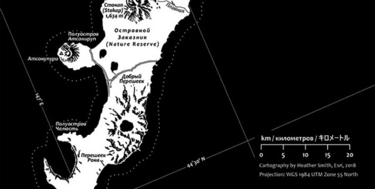

Heather Smith, one of the authors, designed this map to be easy to print on standard-size paper and limited the color scheme to black and white.
