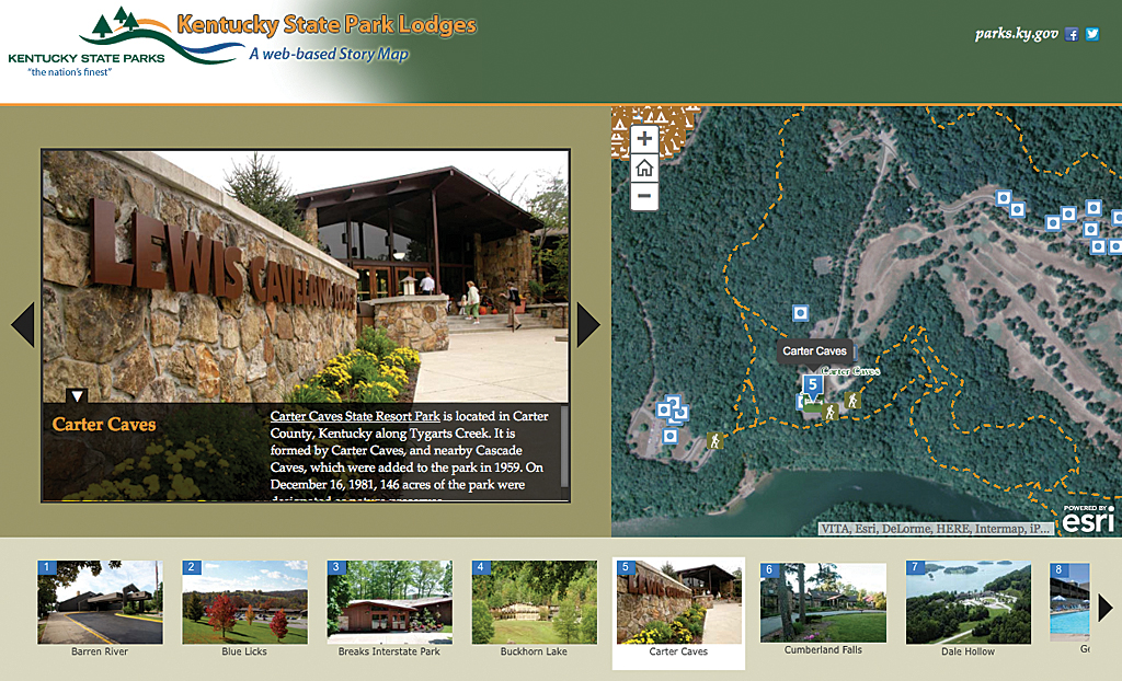

A Story Map app about Kentucky State Park Lodges was the first the Kentucky Division of Geographic Information customized.

The first Story Map app was one highlighting the lodges at Kentucky’s state parks. We collaborated with the marketing and GIS staff at state parks to make this happen. They supplied some outstanding photos and reviewed their GIS data to make sure everything was in order.
The colors in the site were keyed to the logo.
We created a web map on ArcGIS.com using the data, the photos were placed on a web server, and the Map Tour Story Map app template was downloaded from Esri. Wiring up the template to our data was a breeze, but our app had the same look and feel of all the other Story Map apps. We needed to make ours unique and engaging.

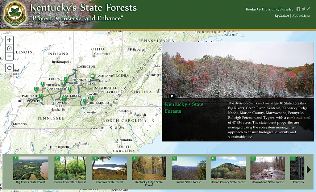

I visited the Kentucky Division of Forestry website, where I copied the new logo. The colors used in the logo were the basis of the site’s color scheme. Using Adobe Photoshop, I got the hexadecimal values for those colors. With those values, I touched up the underlying HTML using Xcode on the Mac. [Xcode is an integrated development environment that is a free download from Apple.]
As noted in the blog post, the inspect element feature in the browser could be used to identify some of the styles driving the Story Map app template. Starting at the top, I first changed the background color of the header to match the green color in the logo.

We chose standard green markers for this forestry-related Story Map app. I did a screen capture of the app and got the hexadecimal value of the marker color using Photoshop. This color was used for the name in the picture panel (Listing 4). The font family was set to match the font used for the links in the header. Consistency in type styles makes for a polished looking app.
Moving to the footer, I chose a nice green color that complemented the color scheme.
