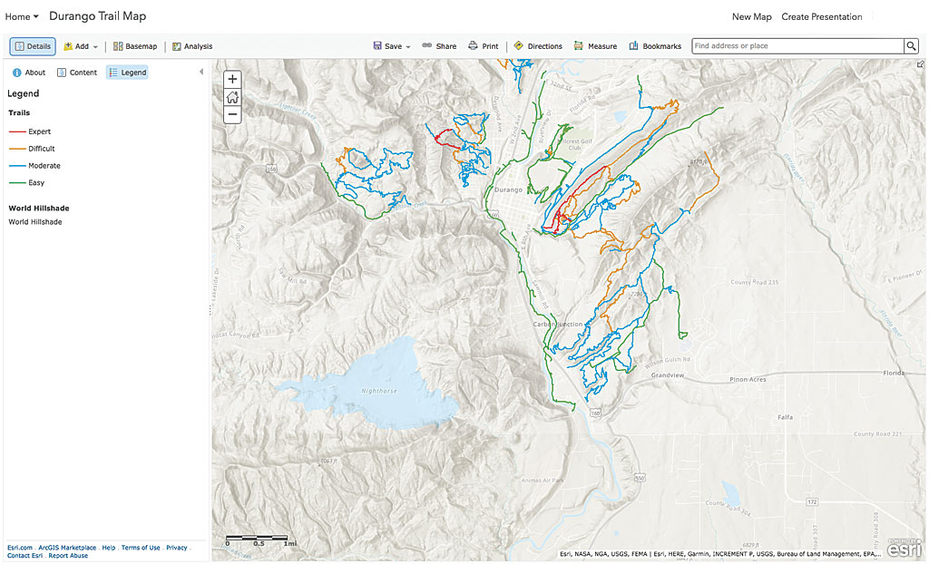

Web maps and web scenes are stored as items in ArcGIS Online and ArcGIS Enterprise. Each item has its own unique ID. To display a map in your app via code, you need the ID. If you don’t have a map ID, you have three choices: search in the gallery for an existing map on ArcGIS Online (there are literally thousands to choose from); create a new map from scratch with Map Viewer or Scene Viewer and store it in ArcGIS Online; or use the sample map and make your own copy of it.
The sample web map has been designed with the World Vector Tile Topographic basemap overlaid with the World Hillshade layer with transparency set at 50 percent. The trails layer is on top and has been classified by difficulty. Its pop-ups have been customized to display information as text as well as some field data.

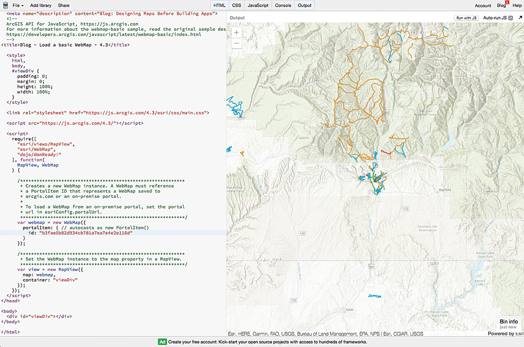

Now that you have a map ID, you can use the ArcGIS API of your choice to load and display the map. With the ID, the ArcGIS API knows how to access the item (PortalItem) on ArcGIS Online. The item is stored as a JSON structure based on the web map and web scene specification.
In this example, we’ll just use one of the samples from the ArcGIS API for JavaScript and the map ID from the sample map saved to My Content to load the map. You should notice that the map has all the same settings and behavior as the map in the viewer. Feel free to copy the jsBin, output, add your own map ID, and give it a try.

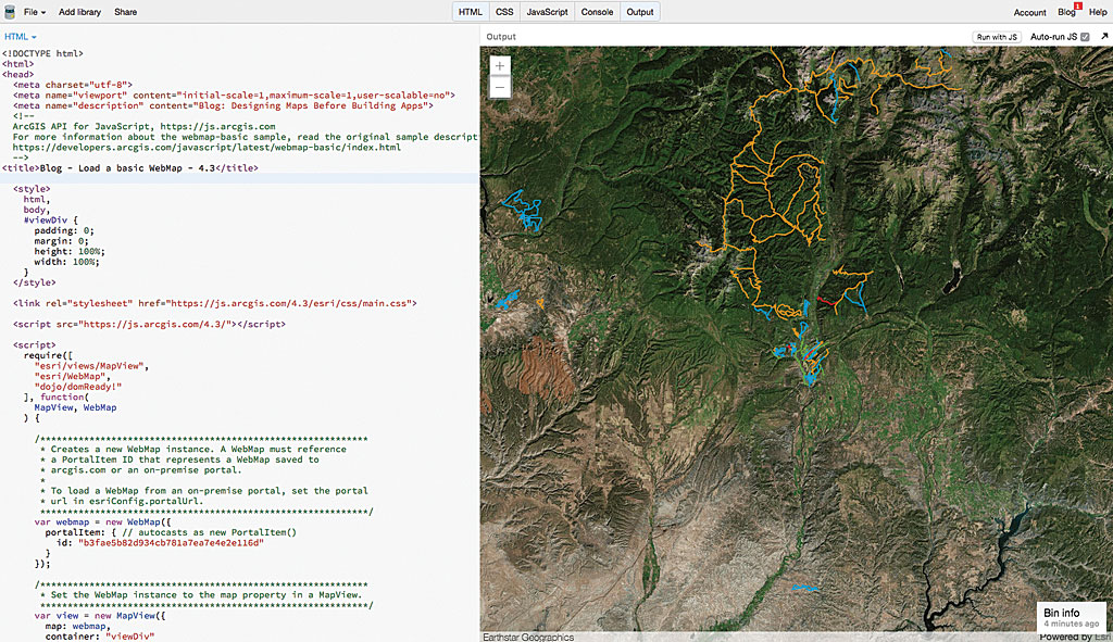

Now here’s the best part. Since the app is referencing the item ID on ArcGIS Online, if you go back to the viewer and update the map, and then refresh your app, the changes will be automatically applied to your application as well—no code updates are required. This is a very powerful way to “remotely” edit the map in your app without actually changing any code.
In this example, we just changed the basemap in Map Viewer to World Imagery, saved it, and then reran the jsBin. Feel free to try to update and save your map and then refresh your web map.
