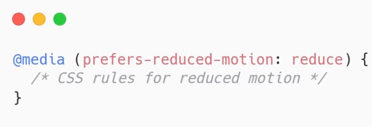

The CSS @media query can be used to detect a preference for reduced motion, and allows you to apply specific CSS rules, as shown in Listing 1.
A CSS code snippet used to detect preference for reduced motion.
Listing 1
