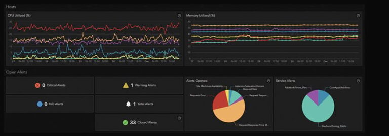

Since its deployment in February 2023, Monitor has helped deliver reliability to the City of Grimes staff. It gives Jameson a snapshot of the entire GIS system and its performance. He primarily looks at CPU, memory allocations, alerts, and status changes for the enterprise GIS and he can easily see how all the components are working together.

ArcGIS Monitor automatically opens and closes alerts and tracks CPU and memory usage.
The alert notifications sent by Monitor and the custom reports (e.g., Analysis views) that are producible have been a significant advantage for monitoring system health. For example, Jameson created a custom report to check ArcSOC usage. [When a client app makes a request to any service running on your ArcGIS Server site, such as to draw a map, geocode a dataset, or run a geoprocessing job, that request is passed to an ArcSOC process on one of the machines in the site.] The custom report provides details on the load when a new service is deployed. This helps Jameson know when the new services are being used without having to review them layer by layer within the database. ArcSOCs are the process on the server handling dedicated and hosted services. A serial chart produced by Monitor allows insight into the demands of service on the hardware itself.
