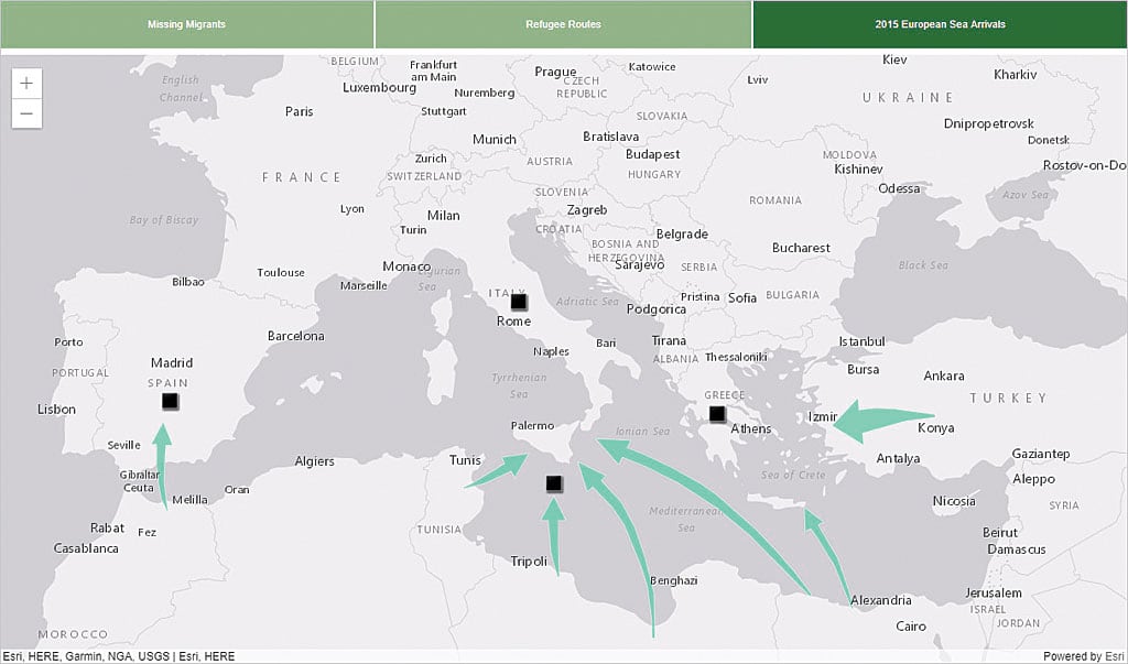

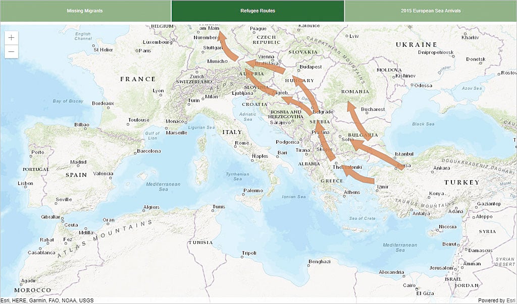

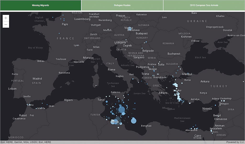

5. Switch between web maps in your app and maintain focus
To tell a story, you might want your app to allow the user to switch between web maps in the app to show different datasets or alternative visualizations. You can either maintain the center, scale, and rotation of the map view when the user switches between the web maps or allow all web maps to be initialized independently using the properties originally saved in each web map.
If you want a smooth experience when showing different datasets or visualizations of the same location without changing the map’s focus, maintain the center, scale, and rotation between web maps. If the web maps have data appropriate for different extents or scales, you’ll probably want to use the properties saved with the web map. With either approach, the first step is to create a WebMap object for each web map you want to display by referencing the web map ID.
To maintain the center, scale, and rotation between web maps, assign the web map you want to be displayed to a single instance of the map view.
To use the properties saved with the web map, create a new map view object for each web map and display the currently selected view.
To play with this functionality, go to js.arcgis.com, click the Sample Code tab, and search for “swap web maps.”
