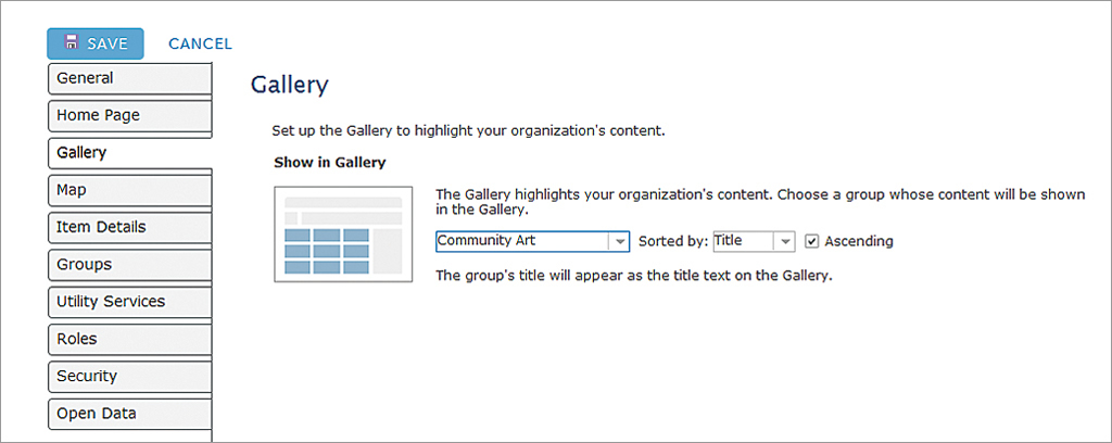

Organization administrators use groups to populate the organization’s home site featured content ribbon and the organization’s gallery. These are set by choosing MY ORGANIZATION > EDIT SETTINGS, selecting theAv Home Page tab, and then choosing the group to use for Featured Content. Gallery contents are set by selecting the Gallery tab, then choosing the group to populate the organization Gallery.

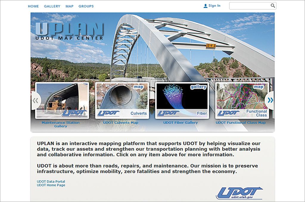

As an administrator, you can use Groups to populate the featured content ribbon and gallery for your organization's home site on ArcGIS Online. The Utah Department of Transportation UPLAN site does this.

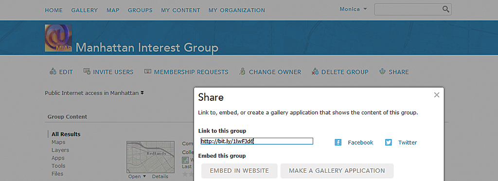

Share a Group
Open the group, click SHARE, then use the shortcut URL link.

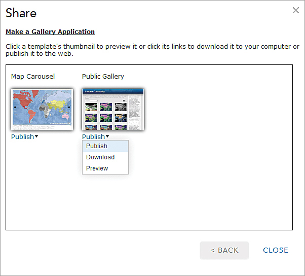

  1. To use the gallery app, click SHARE, then MAKE A GALLERY APPLICATION.
  2. Choose Publish to create a new application item.

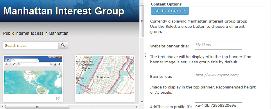

  4. Save and configure the gallery application using the configuration panel.

Set a Group as the source for a gallery by choosing My Organization > Edit Settings and selecting the Gallery Page tab.
The first step in sharing a Group, making a Group gallery app, or embedding a Group gallery is to open the Group and click the SHARE link on the far right side.

From the Share dialog box, click MAKE A GALLERY APPLICATION to make a group gallery into an app, then choose Publish from the drop-down under Public Gallery.
After choosing MAKE A GALLERY APPLICATION, click CONFIGURE APP to modify the banner, logo, and other features of the gallery app, then copy and paste the HTML into your website.
