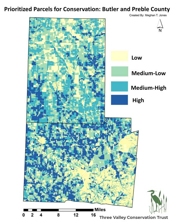

Final parcel results for the study area in southwest Ohio. Scores are evaluated in quantiles (0–25; 26–50; 51–75; 76–100) to represent areas to prioritize for conservation.

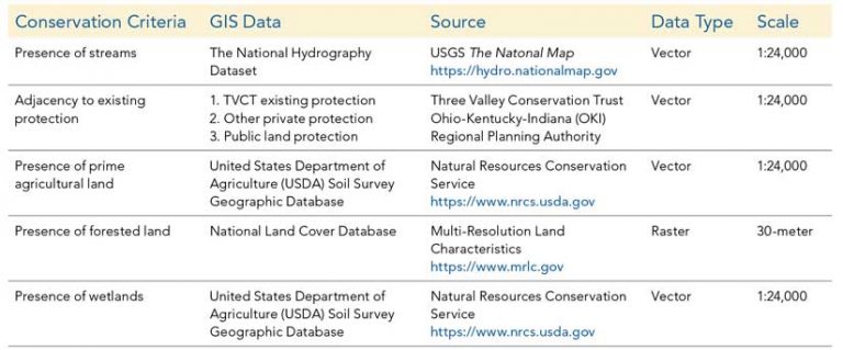

Table 1. Data type, source, and scale for each conservation criteria submodel

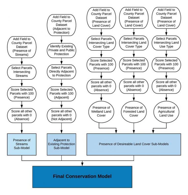

The tool, the Land Priority Protection Model (LPPM), utilizes ModelBuilder in ArcMap 10.6 to identify areas of land best suited for conservation. It applies conservation criteria to private land to weight, rank, and strategically score parcels. The decision support criteria are the fundamental components of LPPM.
TVCT identified three overarching evaluation criteria for identifying potential parcels of high value: presence of streams, adjacency to existing protection, and the presence of desirable land-cover/land use (land cover/land use types include wetland, forest, and agriculture use). Each criterion is evaluated within its own submodel and calculated individually. The final conservation model is computed last to accommodate all other criteria calculations. While the primary purpose of the model is to identify high-priority land to apply conservation easements, the model needed to be versatile so that variables can be excluded or weighted differently.
Three Valley Conservation Trust is a nonprofit agency with limited funding. It favors using publicly available data sources such as the National Land Cover Database and the National Hydrography Dataset for analysis. Some of the open data sources are listed in Table 1. All data utilized wascollected through free national or state platforms; this is very important to the land trust for several reasons such as cost, availability and reliability. After collection, all data were imported into ArcGIS and reprojected to NAD83 Ohio South State Plane Feet, clipped to the study area, and imported into a geodatabase before being included in the model.
Visual workflow of Land Priority Protection Model construction. Each submodel evaluates an individual conservation criterion and creates a field in the parcel dataset attribute table with a presence-absence score. These scores are analyzed in the final model.
ModelBuilder as a Useful Solution
ModelBuilder was chosen as the main platform for data manipulation and analysis for its versatility. Several toolbox tools with different workflows were created, which cut down the time that would normally be spent opening and running separate tools. ModelBuilder is a visual workflow creator that offers a flexible interface, providing easy editing and streamlining automation of frequently run processes. Users can assess conservation criteria individually and together.
LPPM automates the process of prioritizing parcels based on various conservation scenarios. When using the submodel, the user determines whether to include or exclude criteria and assigns relative weights to each criterion. For example, if a funding agency prefers different conditions or criterion weight for conservation easement applications—such as the presence of wetlands—those variables can be weighted higher before running the final priority model.

Each criterion for identifying potential parcels of high value is handled by a sub-model. Each submodel has a specific purpose: to create an attribute field for holding score. For example, the Presence of Streams submodel selects every parcel in the study area that intersects a stream and assigns it a score of 100 because a stream is present. All parcels that don’t intersect a stream receive a score of 0, denoting the absence of streams.
After each submodel has been run, the parcel dataset contains five new fields that hold scores for each evaluation criterion. The appended parcel dataset is then used to run the final conservation model.

The final analysis adds a field to the parcels dataset to store the final priority score. This score is calculated as a sum of each criterion present for each parcel multiplied by the individual weight assigned, which ranges from 0–100. A weight of 100 represents the most desirable land for conservation, and a weight of 0 represents the least desirable land for conservation. Results are symbolized in even quantiles from 0–100 based on the final conservation index parcel score. Of 201,477 parcels evaluated, only 514 (0.2 percent) scored a perfect 100, while 3,777 parcels (1.87 percent) contained the highest priority score ranging from 75–100.
