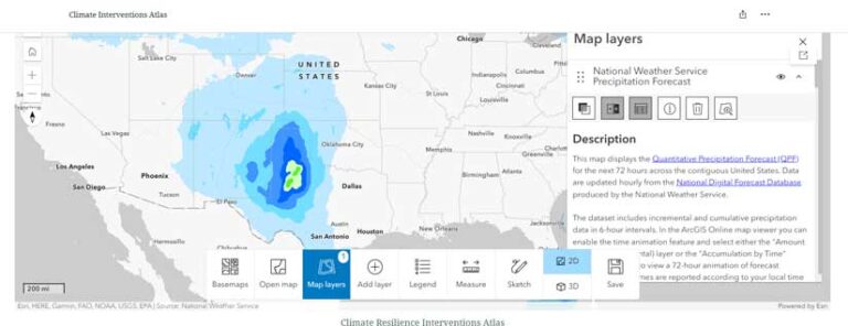

Apps created with the Atlas template in Instant Apps allow GIS analysts to easily share data and maps in context that enable users to conduct simple analyses and allows for easy sharing. This map from the Climate Intervention Atlas shares data and maps from the National Weather Service Precipitation Forecast.
