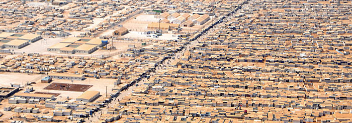

A view of the Za’atri camp for Syrian refugees from a helicopter in 2013. Photo by the United States Department of State/Flick
As of April 5, 2017, the United Nations High Commissioner for Refugees (UNHCR) and the Syria Regional Refugees Response (SRRR) report that Jordan hosts 656,913 “registered” Syrian refugees. Of this number, 140,990 (21.5 percent) are in refugee camps, while 515,923 (78.5 percent) are scattered across Jordanian urban territories. Al Za’atri camp, which has grown to encompass more than one camp, is the largest refugee camp in the world. Its population as of 2015 was 71,227, and it is the fourth largest populated place in Jordan.
