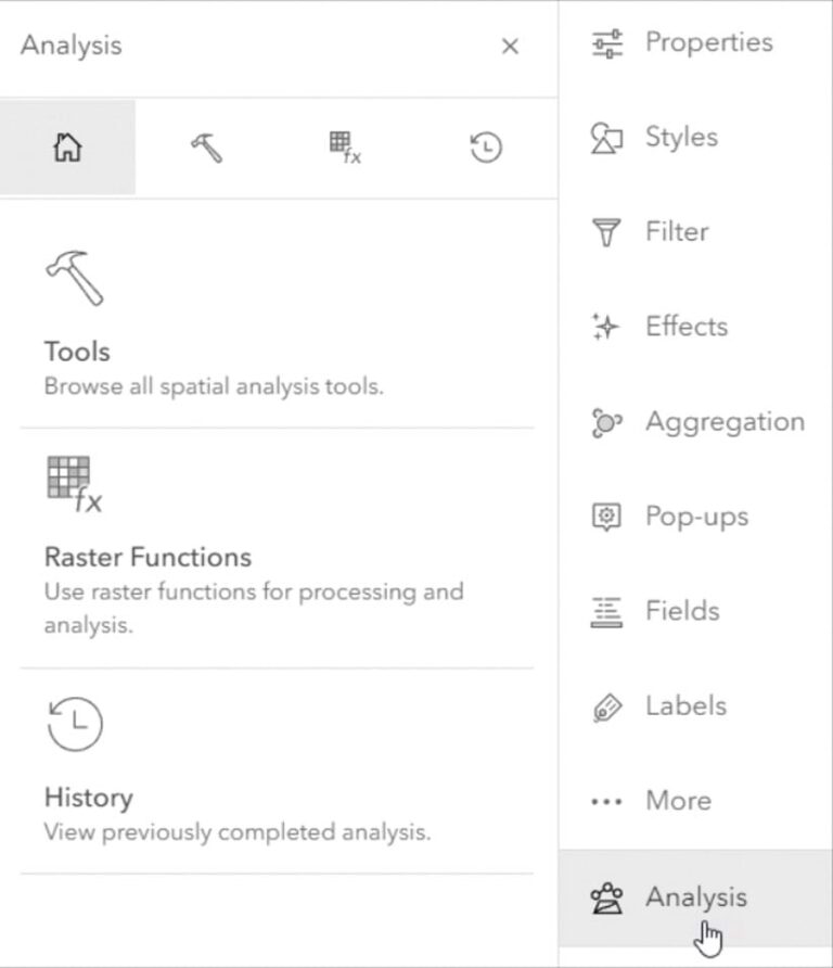

ArcGIS Online provides analysis tools that enable you to perform spatial analysis and gain insights from your data. If you have appropriate privileges, these tools can let you summarize data, find locations, analyze patterns, enrich data, and perform proximity analysis and other operations. These tools can be accessed by clicking the Analysis button on the Settings (light) toolbar. Raster analysis tools and raster functions are available via ArcGIS Image for ArcGIS Online.

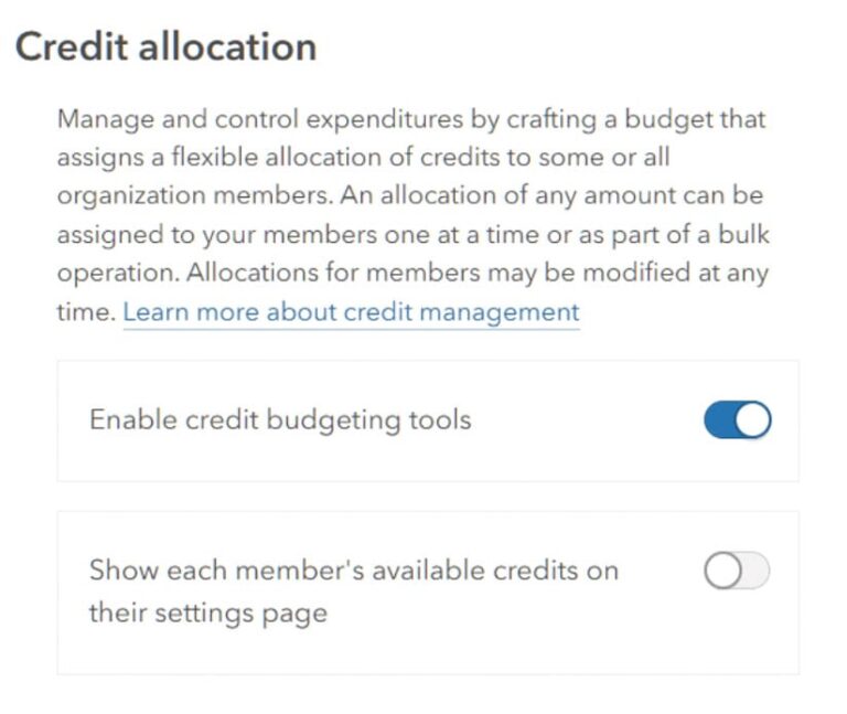

Administrators can also configure credit consumption for members. These limits apply to members using analysis and other tools. Credit budgeting applies to transaction-based services and tools, such as data enrichment, publishing, and spatial analysis. Click the Settings tab for your organization, and in the Credits section enable credit budgeting tools.
