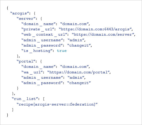

Listing 1 shows a simple recipe that you could use by opening it in a text editor and replacing "domain.com" with the domains you use for ArcGIS Server and Portal for ArcGIS.

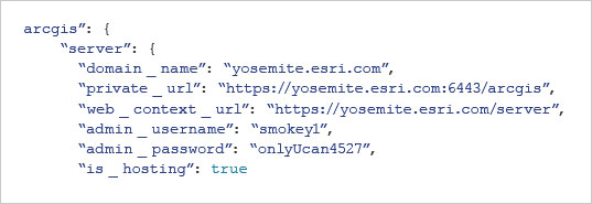

Listing 2 shows how the recipe would look if your domain for ArcGIS Server is yosemite.esri.com, your admin_username is smokey1, and your admin_password is onlyUcan4527.

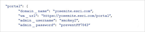

Listing 3 shows how this would work for the portal section of the recipe.

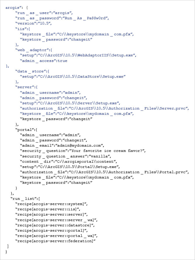

Listing 4 shows how you would modify the webgis-windows.json file. You provide the version of your software, the path to your keystore, the keystore_file, keystore_password, and the correct pth to your setup and authorization files.

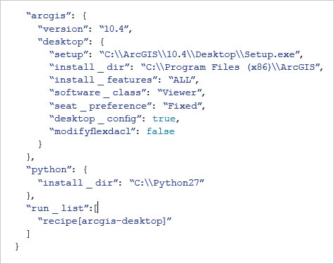

Listing 5 shows a simple recipe for installing and authorizing ArcGIS software
The listings that accompany this article demonstrate how easily you can modify and use recipes. Listings 1 to 4 show how to use an ArcGIS Cookbook recipe to federate an ArcGIS Server with Portal for ArcGIS, a task you can do manually but one that can be automated with Chef. You can use this recipe not only for your initial configuration but later when you have added another ArcGIS Server to your deployment. After making changes to the recipe and saving them, use the Chef Client you installed to run the script by typing “chef-solo -j C:\chef\roles\webgis-windows.json” at the prompt (C:\) in the command prompt window and pressing Return.
If you don’t have ArcGIS installed on a laptop or PC, you might want to try the simple recipe shown in Listing 5 for installing and authorizing ArcGIS Desktop.
