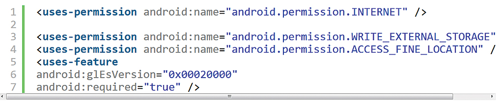

Update the Android Manifest
Open your Android Manifest file by double-clicking the AndroidManifest.xml file in your project directory. Add the elements to your project shown in Figure 1. Note: You should add the appropriate <use-permission> that your application requires. You do not need to add ACCESS_FINE_LOCATION if your app is not using location sources such as GPS or WRITE_EXTERNAL_STORAGE if your app is not reading or writing files from external storage.
Figure 1
