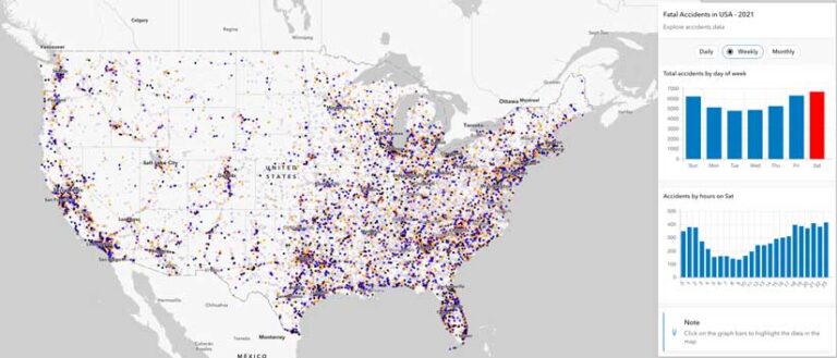

This sample application visualizes all 2021 fatal car accidents across time zones in the United States. The data is color coded by the time of day, that is, morning, afternoon, evening, and night. This data was obtained from the Fatality Analysis Reporting System (FARS) provided by the National Highway Traffic Safety Administration. View the source code for this application.
Visualization of all fatal car accidents in 2021 across all time zones in the United States.

The charts displayed on the right side of the application offer a breakdown of the total number of accidents based on time of day, weekdays, and months. In the weekday chart, you can explore accident data by hours for the selected day of the week, while the monthly chart provides a breakdown of accidents by days within the chosen month. An analysis of accidents by hours on weekdays highlights the noticeable increase in accidents during late-night and early morning hours, particularly on weekends.

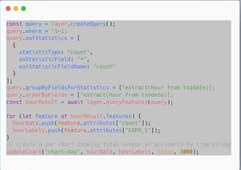

These charts are generated by querying the dataset to obtain accident counts. The query involves extracting information about the hour, day, and month from the timestamp offset field available in the service. For example, the total accidents by time of day chart data is efficiently prepared using timestamp offset values. This approach enables seamless time-based analysis across multiple time zones. For example, data captured at 8:00 am in Hawaii with data captured at 8:00 am in New York can be compared because both were recorded in the morning relative to their respective time zones.
While it may have been possible to generate this information using a traditional date field, it would have required additional information, such as the state, to determine the localized time offset and ultimately the local time of each accident. This is complicated by the fact that some dates honor Daylight Saving Time while others do not. The code in Listing 2 demonstrates how the data for the total accidents by time of day chart is prepared. It involves querying the accident data, extracting the hours from the timestamp offset field values, and obtaining the total count of accidents grouped by the hours.
Listing 2
