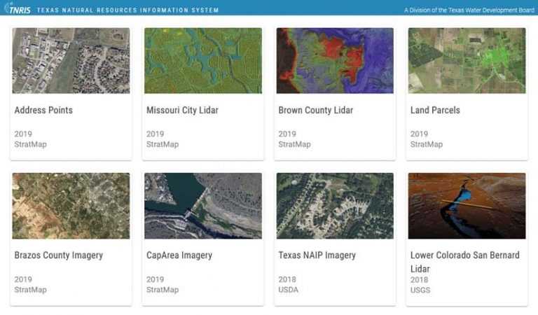

The TNRIS DataHub (data.tnris.org) makes address point, land parcel, and other statewide datasets available.
