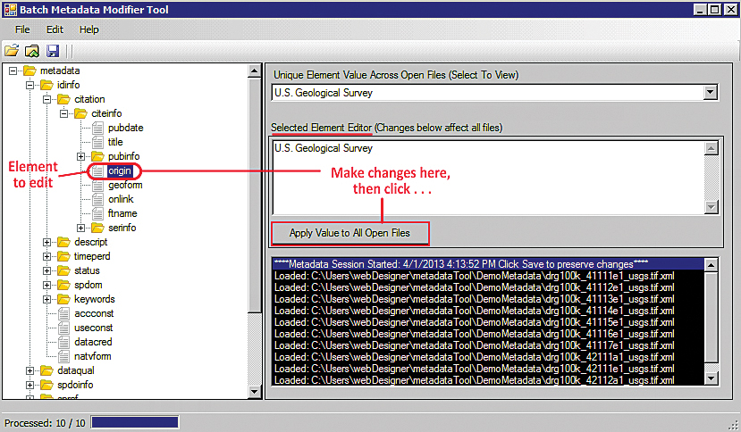

In the Unique Element Value Across Open Files drop-down menu, the user can edit the value in the window below it and replicate those changes across all similar elements in all open files.

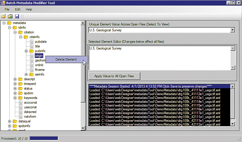

Iteration capabilities are imperative when the task at hand involves applying identical updates to large batches of files. The Batch Metadata Modifier Tool is simple to use and eliminates the need to perform protracted, mundane repetitions of identical operations on multiple files individually. A user can open a single file or group of files via the ArcCatalog Contents Tab to modify existing elements, find and replace element content, delete a metadata element, or import metadata elements from external templates.
The metadata structure for a file or many files is presented as a hierarchical tree in the left-hand window. The user can navigate through the tree and examine the values of each element, which are listed in the Unique Element Value Across Open Files drop-down menu on the left. The user can edit the value in the window below it, and then, if desired, replicate those changes across all similar elements in all open files. The Batch Thumbnail Creator Tool is similarly simple to use. A user can open a single file or group of files via the ArcCatalog Contents Tab to generate thumbnails.

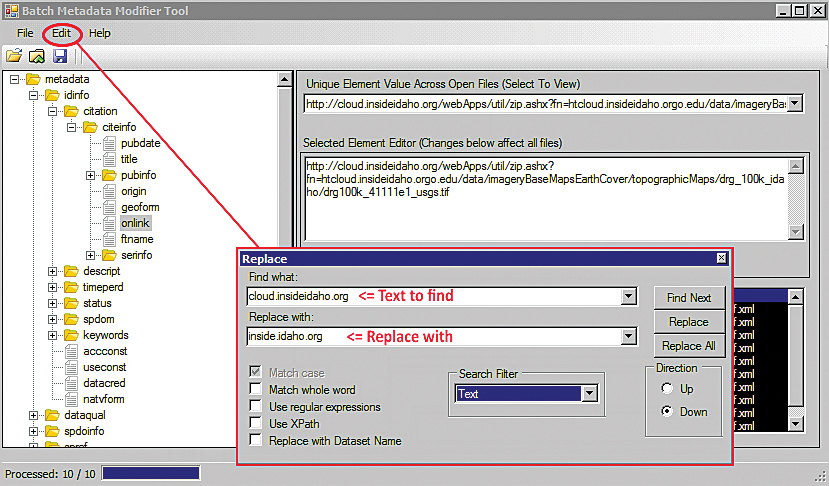

The Batch Metadata Modifier Tool can also find and replace element content.
