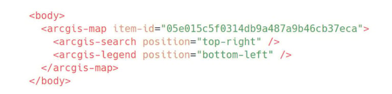

Compare the difference between the imperative/procedural approach in Listing 1 with the declarative-first approach of web components shown in Listing 2, which shows code for a web map built with the @arcgis/map-components package from JavaScript Maps SDK components.
Listing 2: Web map built declaratively with components.

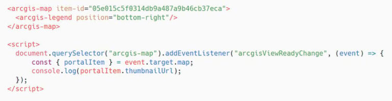

You can see that with map components, JavaScript is not necessary to achieve the same solution. This eliminates the need for the viewDiv container element. It also eliminates the need to separately initialize the WebMap and MapView. It is important to note that while the example shown was written purely with web components, the underlying core API is still available, creating a balance between the imperative and declarative programming paradigms, as shown in Listing 3. This flexibility allows you to reap the benefits of both approaches.
Listing 3: When web components, the underlying core API is still available.

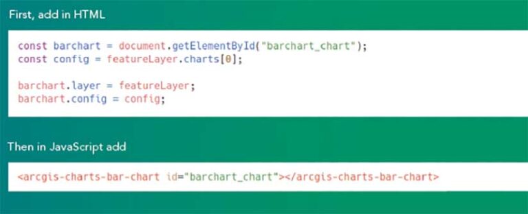

The Charts components package offers a series of charting components that can be added to your applications to provide another dimension to maps—for example, emphasize trends or illustrate comparisons in your data. When used alongside maps, charts can provide a complete data visualization story of your data. They can be configured in Map Viewer and saved to your web map or layer, then simply loaded in the chart component in your app (as shown in Listing 4) or defined directly in code.
Listing 4: The configuration for the bar chart is read from the feature layer item that was configured in Map Viewer. The data displayed in the chart will come from the feature layer.
