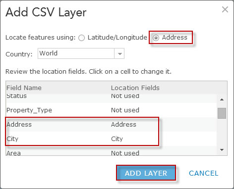

- Open the map. Add the CSV file for the homes to the map. You can download it here [ZIP]
, then click and drag it onto the map from the folder in which you saved it. - Note that the address locator will be used with the Address and City fields in the CSV file to find the point locations. Click ADD LAYER.
The address locator is used to find the locations of the points in the CSV file. The map will zoom to the location of the points.

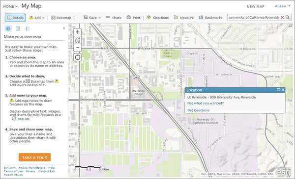

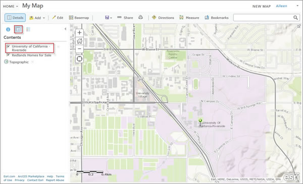

After adding points from a CSV file to a map, the display automatically zooms to the extent of the data. - Find the work location by typing “University of California Riverside” in the search box at the upper right of the screen. The drive time will be measured from this point along roads to create the areas. The map will zoom to the location you specified.
Use the search box to quickly and easily find where you want to start your drive-time search. - Click the X at the upper right of the Location box to close it.

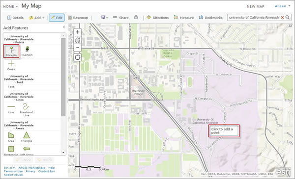

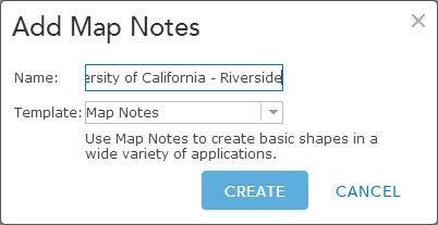

- Click Add at the upper left of the screen, then click Map Notes.
- Name the location so that you can easily identify it and then click CREATE.

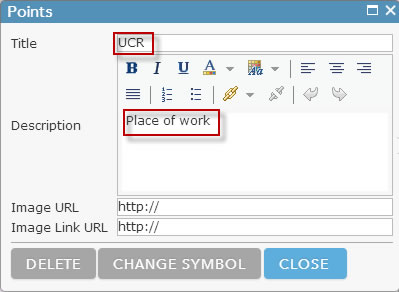

The name you enter will be displayed in the map legend. - Click a stickpin, pushpin, or other symbol in the Add Features box at the left and then click the location on the map.
The symbol you choose will be added to the map. Name the location in the title and, if you want, add a description, then click CLOSE. The symbol will be added to the map.

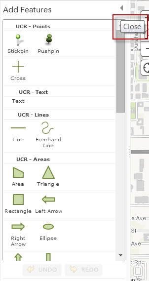

The information you add here will appear in the pop-up window when you click the map symbol. - Click the arrow to the right of Add Features to close the Add Features dialog box.
Clicking the arrow at the upper right of the Add Features dialog box will close it. - Click the Content button to see the new map notes layer in the table of contents.

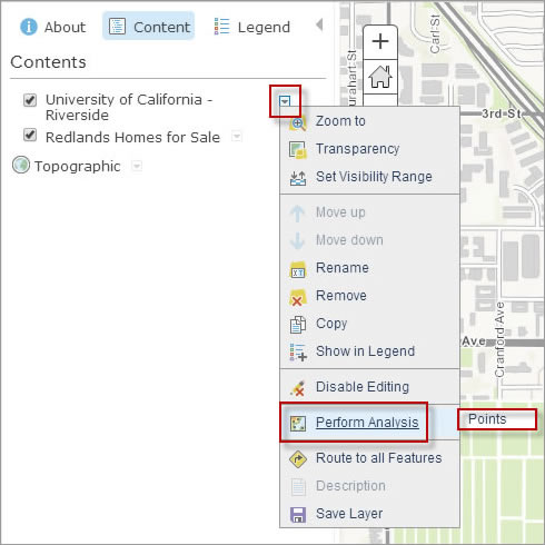

- Click the arrow to the right of the map notes layer in Contents.

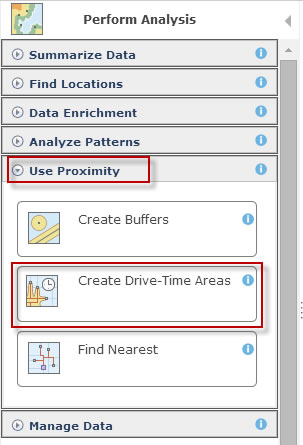

- Click Perform Analysis and then click Points.

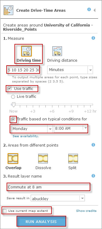

Click Perform Analysis to access the various spatial analysis capabilities. - Click Use Proximity and then click Create Drive-Time Areas.
Drive-time analysis is one of the proximity analysis tools in ArcGIS Online. - To create areas that are measured using driving time rather than driving distance, click the option to measure drive time, then input 10, 15, 20, 25, and 30 minutes. Separate these values with spaces when you input them.
- You can also use traffic information to refine the drive-time areas based on current traffic speeds referenced from sensors and predicted traffic speeds that are calculated by referencing live traffic feeds, historical speeds, and current events such as weather. Traffic speeds are predicted 12 hours into the future, so you can move the slider to set the departure time ahead by up to 12 hours. Click the Use traffic option and use traffic data based on conditions typical for a Monday at 8:00 a.m. Change the resultant layer name to Commute at 8:00 a.m. Uncheck the option to use the current map extent and then click RUN ANALYSIS.
Create drive-time areas based on driving time or driving distance and use traffic information based on live traffic feeds, historical speeds, and current weather for a day and time you specify.

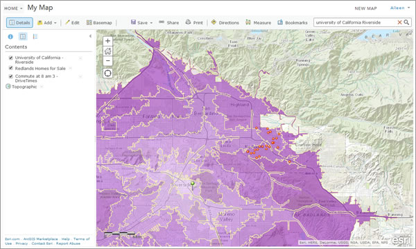

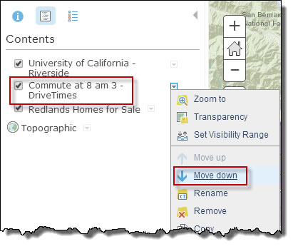

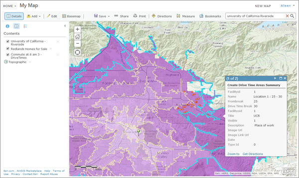

- Zoom out to see the full extent of the drive-time areas. Click the arrow to the right of the drive-time areas layer in the contents and click Move down so that it is easier to see the points.
- Click the name of the new layer in Contents to see what the colors on the map mean.
The drive-time areas are shown as filled polygons. Darker polygons have longer drive times. - Click a drive-time area to see the pop-up window with the drive-time information.
Take a few minutes to explore the map and the pop-up windows. If you want, run the analysis again using a different time, then compare the maps to find the optimal commute time.
