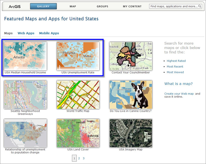

First, choose two web maps that you want to compare. For this tip’s purposes, go to the ArcGIS Online Galleryand select the maps USA Median Household Income and USA Unemployment Rate.
These maps can be placed side by side to explore how the unemployment rate in 2012 compared to the median household income in various parts of the country in that same year.

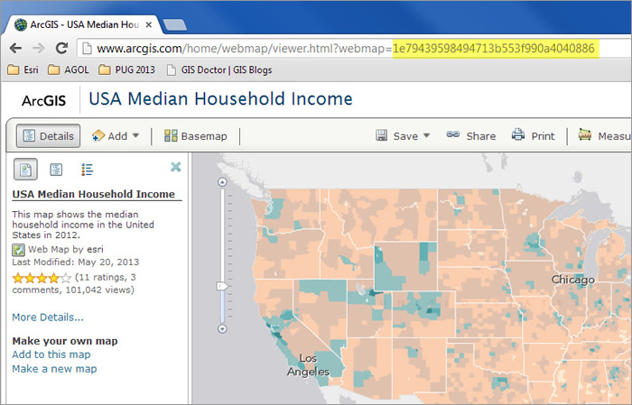

Step 1: Open the USA Median Household Income map. Each map has an ID. Like your social security number or driver license, this ID is unique and can be used to reference the map. You’ll find the ID in the URL for the map. Simply highlight it and copy it. Do not copy the complete URL.

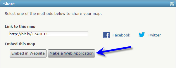

Step 2: Open the second map you want to compare, in this case it’s USA Unemployment Rate. Once opened, click Share and then choose Make a Web Application.

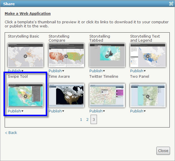

Step 3: Locate the Swipe Tool, currently found on page 3 of the template gallery.
Step 4: Click the arrow next to publish, and choose Preview as shown below:

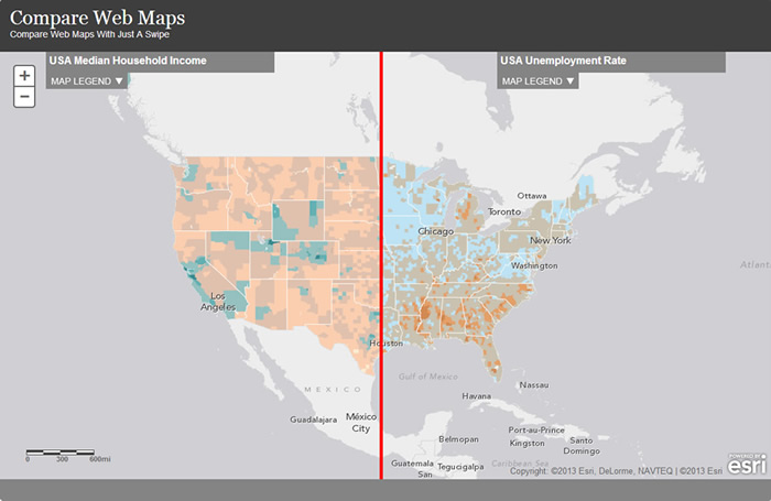

Hit Enter, and you’ve got a quick visual comparison of two maps using the Swipe Tool template. Grab the red line with your mouse and move it back and forth to compare the two maps.
