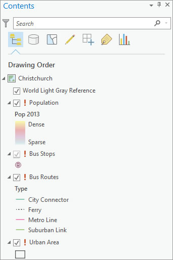

When you open a map or scene, ArcGIS Pro looks for the data referenced by each of the layers in the open map. When a data source cannot be found for a particular layer, that layer doesn’t draw. It only takes one glance at the Contents pane to see those red exclamation points that indicate a broken source.
The red exclamation point next to each layer indicates that the link to the data source is broken.

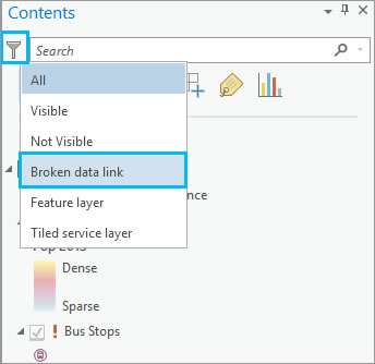

- Quickly filter the Contents pane to show only the layers with broken data source links. Click the Filtericon, then click Broken data link.

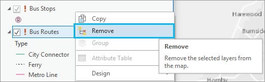

- If you don’t need to work with the layer, you can do nothing to it and continue to work with the map as is or remove the layer by right-clicking it and clicking Remove.

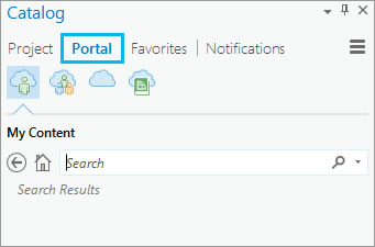

- If the layer is a web layer, remove the broken web layer and add the replacement web layer to your map or scene. After you remove the layer from the Contents pane as described in tip 2, open the Catalog pane and click the Portal tab to search for and add your web layer.

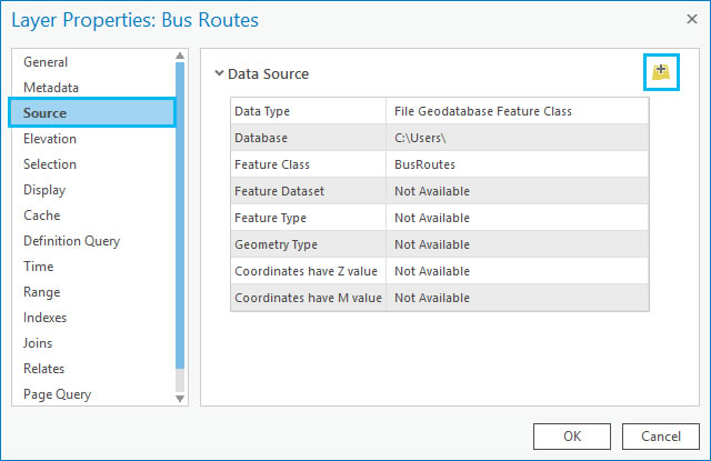

- If you only want to repair a link for one layer, you can change the data source property. Just right-click a layer and then click Properties. On the Properties dialog box, click the Source tab and click Change data source to browse to the correct source.

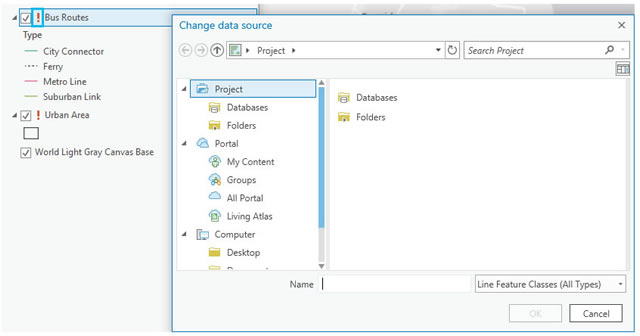

- If you have several layers that reference the same data source and need to be fixed, you can repair the links once in the Contents pane and ArcGIS Pro will automatically repair the other broken layers. For example, if you have several feature classes stored in the same geodatabase and the geodatabase has been renamed, once you update the source, ArcGIS Pro will find all references to that renamed geodatabase and repair them. Click the red exclamation point next to the layer to open the Change data source dialog box and browse to the correct source.
Click the red exclamation point to change the data source. This will update the data source for all layers referencing the same broken source.
