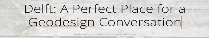

To start creating your Story Map Cascade app, enter a title for your story. Think carefully about the essence of the message you wish to convey. Avoid cutesy, long, or boring titles.
You can also add a subtitle to your Story Map Cascade app—or not. It’s your choice.

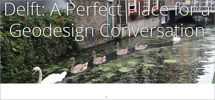

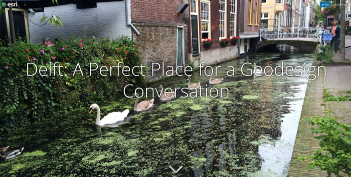

In this case, McElvaney’s photo of swans swimming in a Delft channel was added. The Delft: A Perfect Place for a Geodesign Conversation story map was created to pique people’s interest in attending Geodesign Summit Europe, which was held in the architecturally rich city of Delft. The title of the story map–paired below with McElvaney’s photograph that showcases the city’s beauty and design–is meant to draw readers to the spot where he shot the picture. They can imagine themselves there discussing geodesign, which comes to life in the flowers, the bicycles parked on the footbridge, the symmetry of the swans, and the reflection of the brick buildings in the water.

Select an option and click Save. The first option that features the white lettering and no background box was the most stylistically pleasing choice, as it did not block the view of the swimming swans.
Here is the title and theme with the Cascade Builder panel removed.

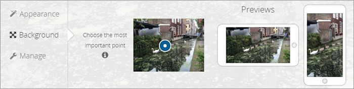

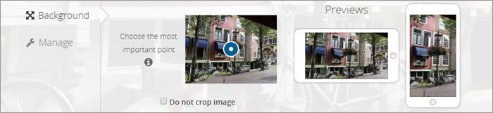

Crop your image for a horizontal and vertical view by using the Background tool. Place your pointer on the blue dot and move it around until the picture is centered on the most important point.

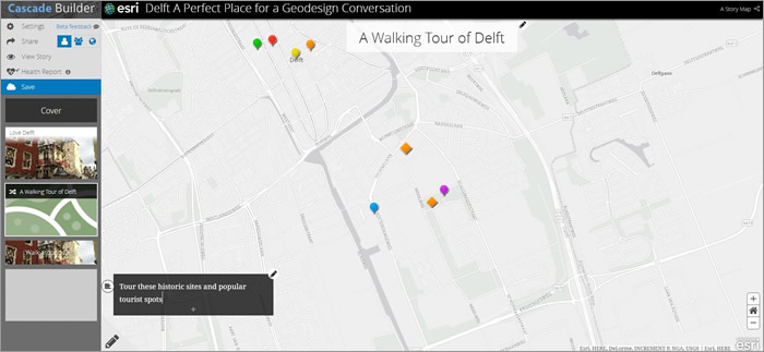

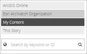

Click Text to write a short introduction. Return to the Plus Sign (+) and click it. Select Media and add a map such as the one of Delft below (authored in ArcGIS Online and saved in My Content).
The map with pop-ups appears below.
Enter a title for the map if desired. The title A Walking Tour of Delft was added. Begin to write your narrative in the black box below, saving often.
Click the pencil in the upper right side of the black narrative box above.

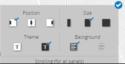

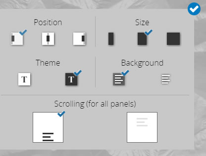

Below you will find the tools that let you position your text to the left, in the middle, or to the right. You can also change the size of the box, choose a background theme, or change the background to show a box. Click the check mark to apply your changes.

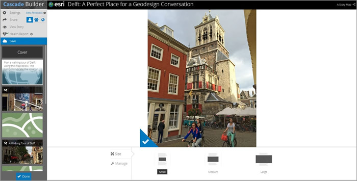

Scroll down and click the Plus Sign (+), then click Media. From a file on your computer (or Flickr, Google+, or Unsplash), add a photo like the one of Delft City Hall below and then click Save.
Click the pencil in the lower left-hand corner of the photo. A check mark will appear, along with the Small, Medium, and Large photo sizing tools.
Adjust the photo size using the tools.

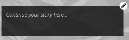

Enter a title and select one of the four themes to style the title. Add a new image and then write more of your narrative in the box that says Continue your story here.
When you click the pencil in the box above, the tools shown below will appear.
You can do things such as change the type size and the position of where the text appears on the screen.

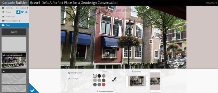

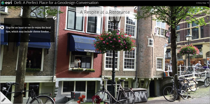

Next, click Media. Add a new image like the one below of a Delft restaurant. Click the pencil again. The following tools will appear. Center your image.
If you check the Do not crop image check box, the Color palette shown below will appear. You can add colors like tan, brown, gray, red, or green to the side panels. Click on each of the nine color options, including beige, green, rose, and gray, and your pair of side panels will appear in the color you choose.
If you keep the Do not crop image check box unchecked, enter a title and select your theme.
Continue working on your narrative in the black box below. Channel your inner Hemmingway or other favorite author.
