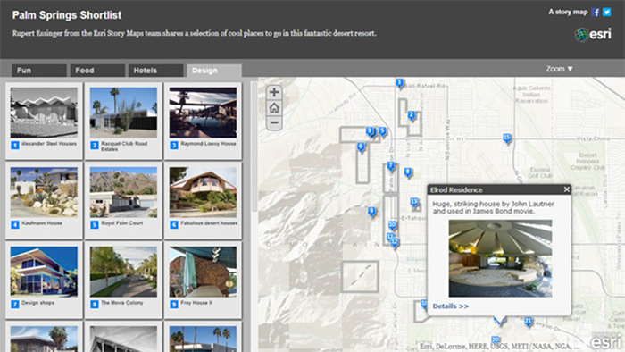

Shortlist is the ideal template to use when you want to present a curated list of points of interest in a particular geographic area. A good example is the Palm Springs Shortlist, which features sections on fun, food, hotels, and design in Palm Springs, California.

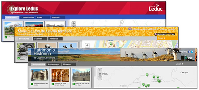

The default Shortlist header is gray, but you can easily add visual spice by changing the color scheme or adding your own custom banner to match your organization’s look and feel. Here are a few examples:

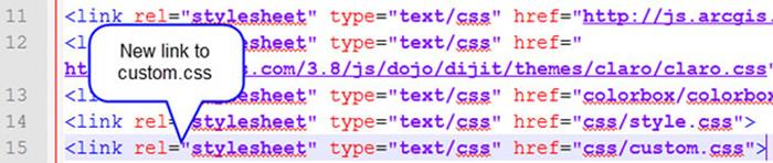

Step 1: Add a link to the custom.css style sheet.
In the index.html file, add a link to the custom.css style sheet that will contain the style changes. Open the index.html file in any text editor, then locate the links to existing style sheets near the top of the file. Copy and paste one of the existing links, then change the file reference to “css/custom.css”, as shown below, and make sure the new link is listed at the end of the links:
Or copy and paste the line below into the index.html file after the link to style.css, as shown above:
<link rel="stylesheet" type="text/css" href="css/custom.css" />

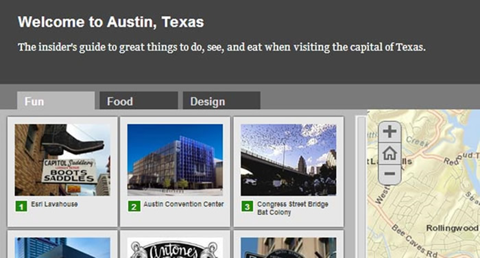

The default color scheme for Shortlist is white text on different gray backgrounds, as shown below:

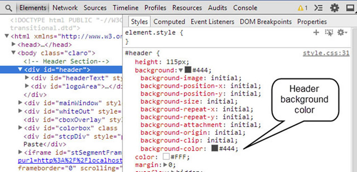

First, you might want to alter the color of the dark gray banner at the top of your application. Using the browser (in this case, Chrome) developer tools, you will see that the banner background color is set in the #header element:

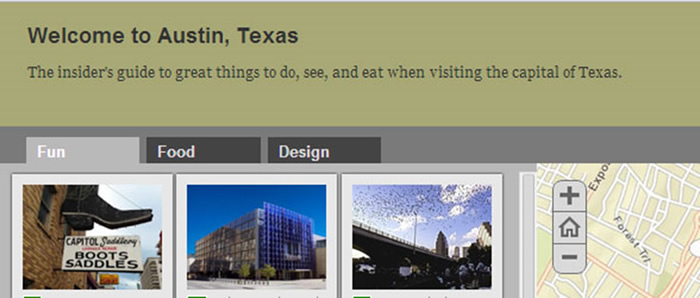

To change the banner color, edit custom.css and use the element id and attributes of the element to set a new background color. In your file, add the id #header and set the background-color attribute to the desired color (in this case, the hexadecimal color value). The id and attribute were both obtained from the inspector shown above.
#header {
background-color: #a8a875;
The above CSS will change the header background to green, as shown below.

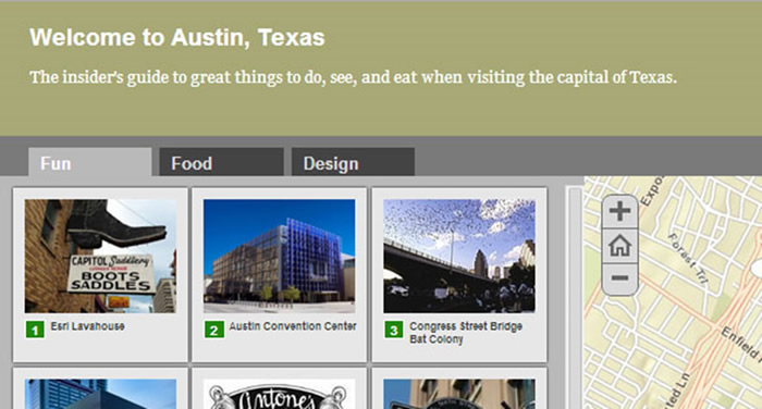

Your Shortlist application banner now has dark gray text on a green background:

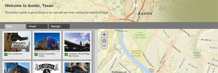

Next, add a background graphic to the header. From the inspector, you will learn that the header is 115 pixels high. Make your background image 115 pixels high and about 1,000 pixels wide, and save it in the images folder. To make the image more pleasing, a fade-to-transparent gradient (which lets the background color show through) was applied to the right side of the graphic.
You also will want the image to display once without repeating and be anchored on the left side. The changes made to the custom.css file to display the background image as described are shown here:
#header {
background-image: url("../images/austin-ban.png");
background-repeat: no-repeat;
background-position: left;
color:#333;

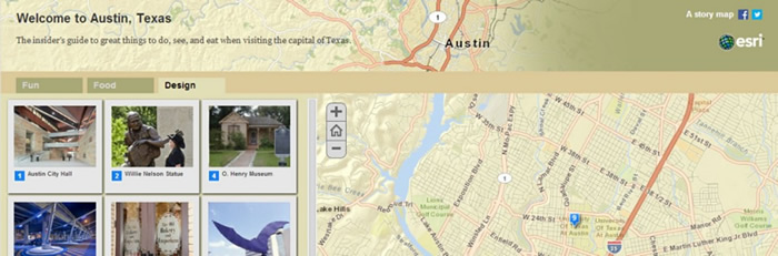

Here’s how your banner will look after these changes:
Doing More
By following the approach used in the previous steps in which you identify elements you want to change and then make those changes to your custom.css file using the id or class, you can continue to tweak your application’s look and feel. The result? Your Shortlist story map will stand out. The Shortlist app in this example has additional customizations for the tab colors, thumbnail background, and header divider:
