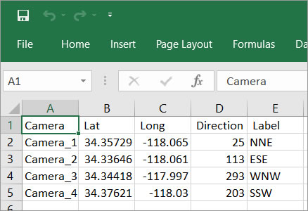

To learn how to create rotating symbols, download the sample CSV file and follow along. The CSV file contains web camera locations (dummy locations, not actual ones) as well as the direction in which the cameras are pointing, expressed as clockwise compass azimuths.
Step 1—Inspect the data.
Open the file using Microsoft Excel, Notepad, or some other text editor to view the contents. Note that the file contains the latitude-longitude location, as well as the direction, which will be used to rotate the symbol.

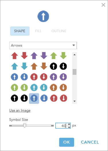

Step 4—Click Symbols to change symbols.
Step 5—Choose an arrow.
Choose an arrow symbol from the Arrows category. Since the rotation values are stored as compass directions with 0 pointing north (up), choose an arrow that points up.
Change the symbol size as desired, then click OK.

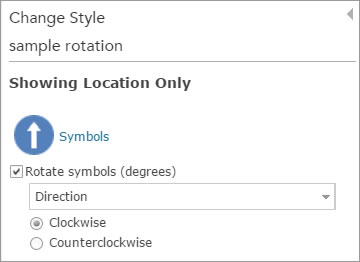

Step 6—Rotate the symbol.
Check the Rotate symbols (degrees) box, and from the drop-down choose Direction as the field containing values used for rotation. The values are already stored in the expected compass azimuth format described above, so Clockwise (the default) is the correct rotation option.
Save your style changes when finished.

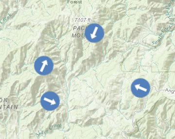

Step 7—View the map.
The map now displays the camera locations, with arrows rotated to show the direction in which each camera is pointing.

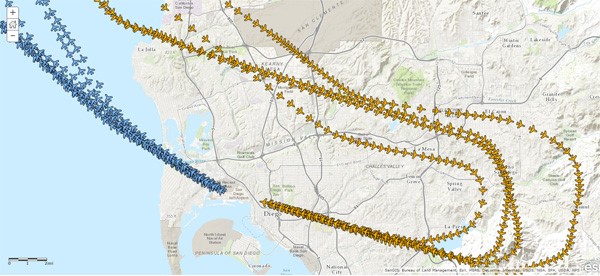

Rotation can be applied to any feature layer in your map. Below is an example showing captured locations for inbound and outbound planes traveling from San Francisco to Los Angeles via San Diego. The layer source is a shapefile, and custom symbols were created to represent the inbound and outbound traffic.

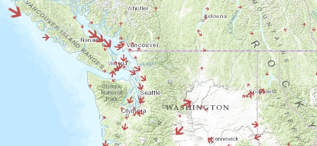

The example below uses a feature service with continually updated wind speed and direction. The symbols are rotated based on direction and sized by speed.
