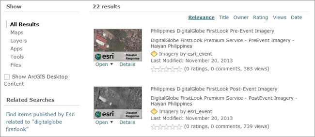

- In the search box on the top right, type “digitalglobe firstlook”.You will see two services DigitalGlobe provides for humanitarian purposes, emergency response, and recovery operations. One service contains imagery taken before the typhoon battered the Philippines, and the other provides imagery of the same areas after the disaster. Below are the full names:
- Philippines DigitalGlobe FirstLook Post-Event Imagery
- Philippines DigitalGlobe FirstLook Pre-Event Imagery

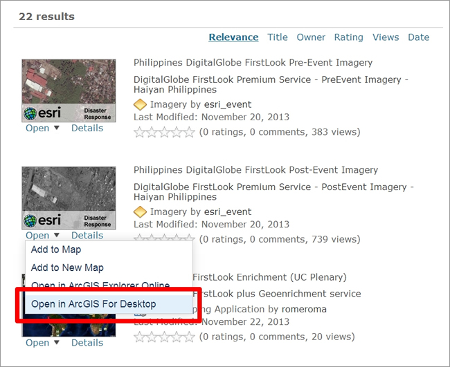

4. Choose one of the services you’re interested in, click the small arrow next to Open, and then click Open in ArcGIS 10.2 for Desktop.
This will download a Portal for ArcGIS item to your browser download folder called item.pitem.

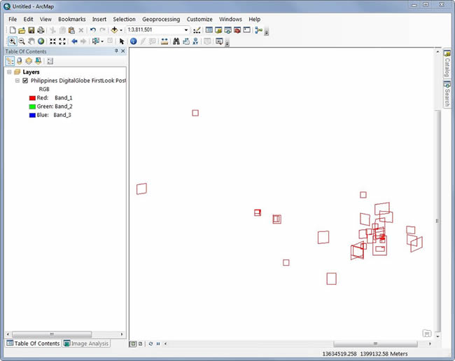

“The service will be available in the table of contents (TOC), but you will see only the wireframes (red outlines of the imagery) because the imagery is loaded at the full extent. The imagery will be displayed only when zoomed in below 1:800,000.

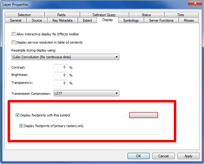

- Right-click the layer in the TOC and select Properties.
- In the properties dialog box, select the Display tab.
- Check the check boxes for Display footprints with this symbol and Display footprints of primary rasters only. Click OK. <>
The footprints for the service should now appear in your data frame. Each polygon in the map represents an individual image.

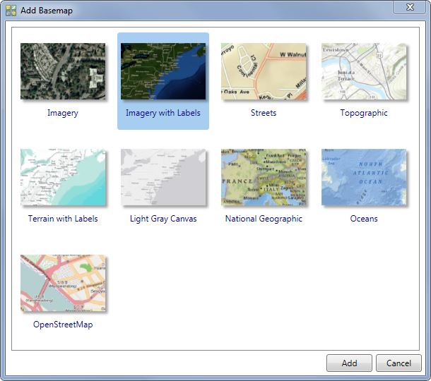

4. On the Tools toobar, click the Add Data drop-down menu and click Add Basemap.
5. Click Imagery with Labels to add a basemap for reference. <>

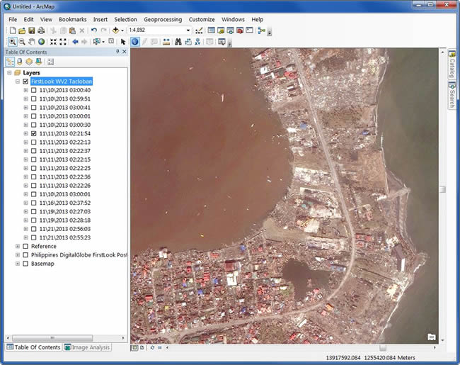

- Zoom in to Tacloban City where there’s a high concentration of imagery. See the screen shot (below) to find the area of interest.
- After you zoom in, use the Select Features tool on the Tools toolbar and select all the scenes in the data frame.
- Right-click the layer in the table of contents and choose Selection > Add Selected Rasters to Map.
- In the dialog box that appears, give the group a name, such as FirstLook WV2 Tacloban.
- On the Layer name based on drop-down menu, select AcquisitionDate for the Layer Name and click OK.
You’ll now have a separate group layer with all the individual scenes listed by date, starting with the earliest.
