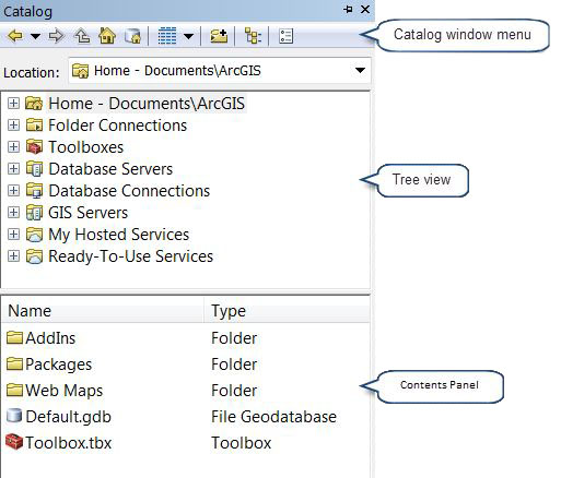

The top panel of the Catalog window shows your GIS contents organized in a hierarchy called a tree view. Here you can navigate among folders and manage connections to things such as servers and databases. You can also select items but only one at a time. To select more than one item, you need to use the Contents Panel.
When you display the Contents Panel, it appears below the tree view and shows information about the item that is highlighted in the panel above. In this lower panel, you can select more than one item at a time.
Working in the Contents Panel is similar to using Microsoft Windows Explorer. You can select multiple items to move, delete, or drag and drop. You can also change the panel’s appearance to see the contents as a bare-bones list, a list with details such as Type, or a view that shows large icons or thumbnail images. There are three steps to follow when working with the Contents Panel: displaying the panel, choosing the view, and selecting the items.

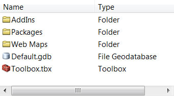

Step 2: Choose the View Used in the Contents Panel
- Click the down arrow next to the Choose View Used In Contents Panel button
in the Catalog window menu. - Choose the view option desired.
The Contents Panel will be displayed using the option you chose, such as Large Icons, as shown below.
