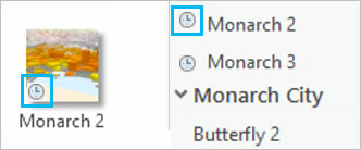

In ArcGIS Pro, bookmarks can also be temporal. If you have time-enabled data, you can create bookmarks at specific points in time. For example, if you have data that tracks the migration of monarch butterflies across North America, you can create a bookmark showing the butterflies’ location midmigration and return to it anytime. Temporal bookmarks display with a clock icon that appears both in the thumbnail and next to the bookmark name in a list view.

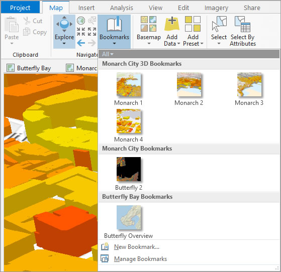

Step 1. Pan or zoom to the location or time that you want to bookmark.

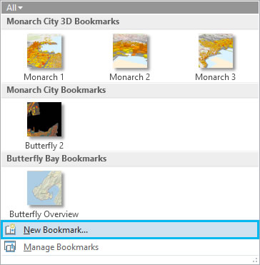

Step 2. On the Map tab, click the Bookmarks drop-down menu, and click New Bookmark.
Step 3. Type a name for your bookmark, then click OK.

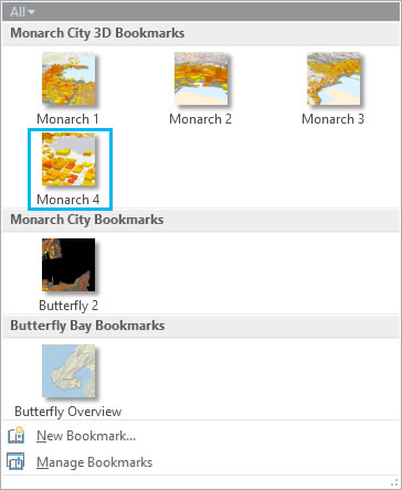

Step 4. Click the Bookmarks button to see your new bookmark and other bookmarks you’ve created in that map or other open maps in the project.
Step 5. Click any of the thumbnails on the Bookmarks menu to go to that location.

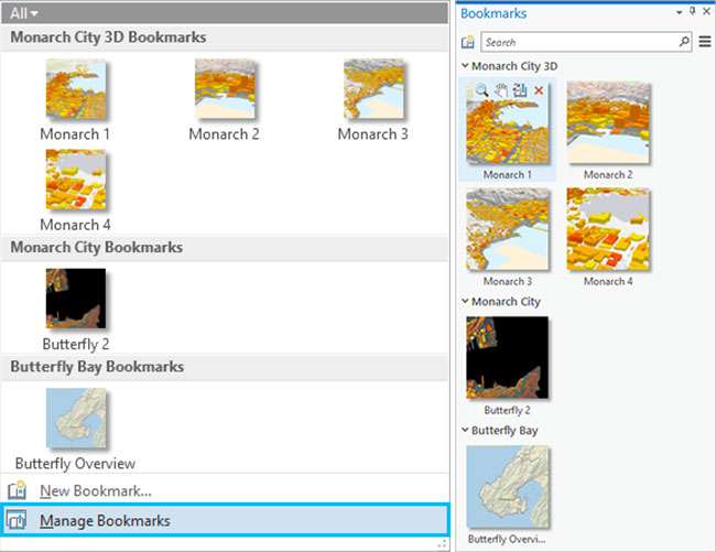

Use the Bookmark Manager
If you want to modify your bookmarks, open the Bookmarks pane. On the Map tab, click the Bookmarks drop-down menu and click Manage Bookmarks.
In the Bookmarks pane, you can do any of the following:
- Reorganize your bookmarks list
- Update the location of a bookmark by clicking the Update button
- Create new bookmarks
- Rename or delete bookmarks
