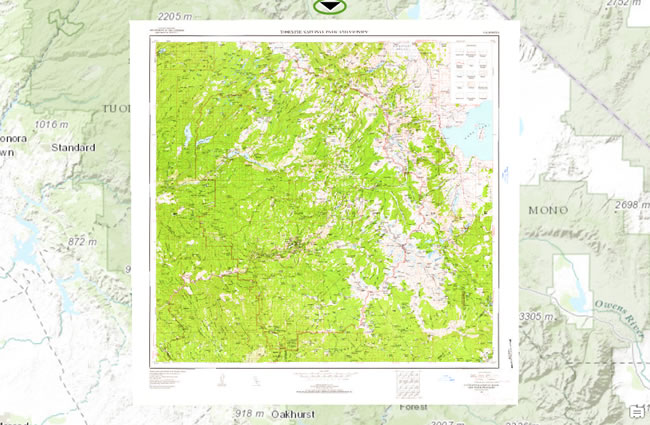

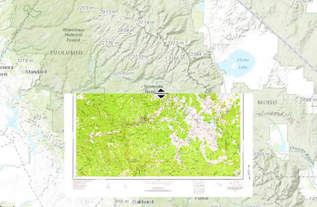

The best way to see underlying layers is to use the Swipe Layer tool, which is on the small but powerful Effects toolbar in ArcMap. This tool allows you to use the pointer to swipe the map viewer from top to bottom. As you swipe, the top layer will be temporarily erased relative to the position of the pointer.
Why would you want to do this? In the example above (and throughout the rest of this tip), the Swipe Layer tool was used to verify that a scanned map of Yosemite National Park in California was correctly georeferenced to align with the basemap. Georeferencing is a process used to add spatial reference information to images so that they can be displayed in their correct location on a map.

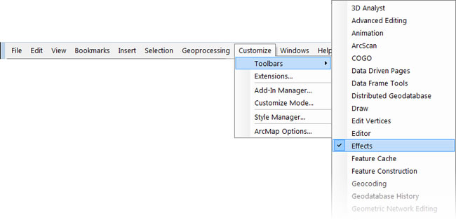

Step 2: Access the Effects toolbar if it is not already open.
- On the Main toolbar, click Customize > Toolbars > Effects.
The Effects toolbar will be displayed.

on the toolbar and position the pointer at the top, bottom, or side of the map window. An arrow will appear indicating the direction in which to swipe the layer. The layer will be temporarily erased relative to the position of the pointer.
c. Click and hold the left mouse button to drag the arrow across the map window. The swipe layer will temporarily disappear from view in the direction you drag the arrow.

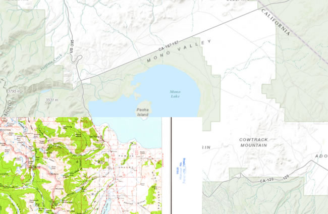

In this example, the Swipe layer tool helps you to see that Mono Lake and the US Highway 395 in the scanned map align with the basemap, thus verifying that the map was georeferenced correctly.

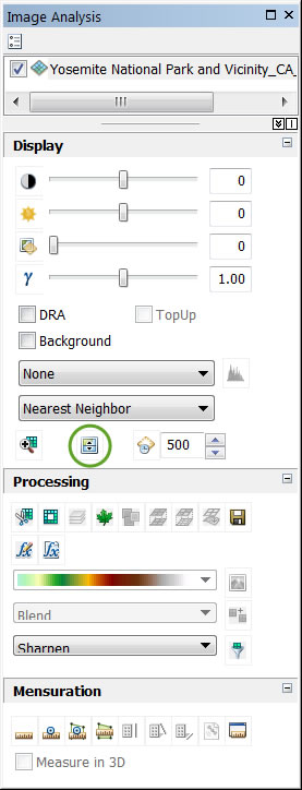

Note that you can also access the Swipe Layer tool from within the Image Analysis window, where you interact with raster layers.
When you use the tool in the Image Analysis window, the layers that can be swiped will always be raster layers. When you access the tool from the Effects toolbar, it can be used with any raster or vector layer the table of contents.
