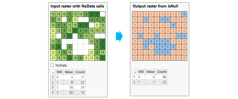

Identify NoData cells
There is a tool that explicitly identifies NoData cells, the Is Null tool. It checks each cell and returns a value of 1 if a cell is NoData, and a value of 0 (zero) if a cell is any other value. If the resulting raster has values of both 0 and 1, then the input raster has NoData cells present. In the attribute table of the raster, the Count field tells you how many cells there are of each value.
In the following example, the input raster is on the left with the NoData cells rendered in white. This raster has 9 rows of 10 columns, and thus has 90 cells. There are four unique values (3, 9, 15, and 22). Summing up the cell counts of each value (11, 22, 25, and 10, respectively) gives a total of 68 cells. Taking 90 and subtracting 68 from it tells you there are 22 NoData cells in the input. The output from Is Null and its attribute table is shown on the right. The cell value of 1 represents NoData, and it matches the expected count of 22 cells.
Identify NoData cells with IsNull
The Is Null tool identifies NoData cells in an input raster

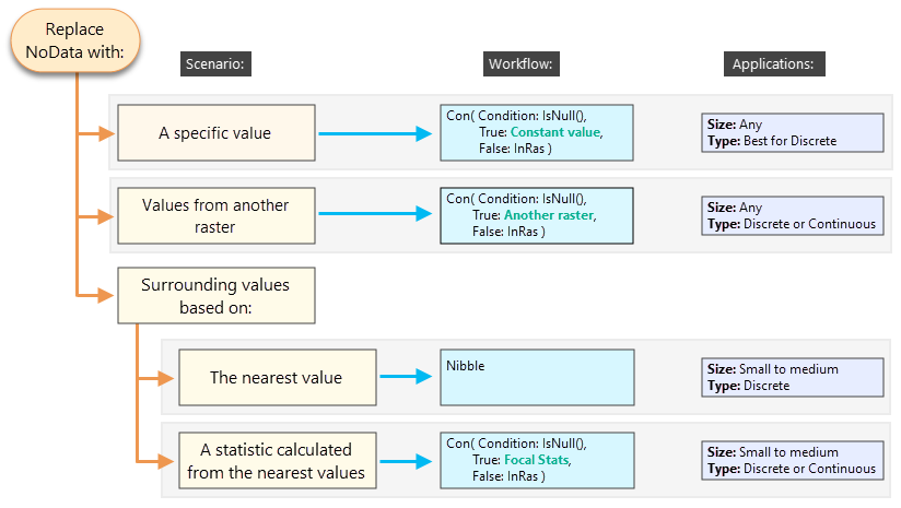

Workflows for replacing NoData
The following graphic illustrates these four workflows at a general level. The column on the left lists the scenarios according to where the replacement values will come from. The center column shows the basic workflow to use for each scenario. The rightmost column provides some information on the general applicability of the scenarios, considering the size of the NoData area and the type of data.
Common workflows to replace NoData cells in a raster
An outline of some common workflows for replacing NoData in a raster.

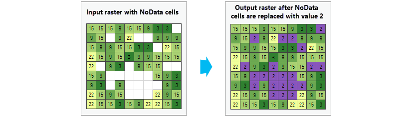

A: Replace NoData cells with a specific value
The easiest way to fill NoData is to replace those cells with a specific value.
Since the same value will be used for all instances, it can be applied to all the NoData cells without having to consider their size or distribution. This method is most suited for discrete data.
As shown earlier, you can use the Is Null tool to create a raster that uses a value of 1 to indicate where a cell in an input raster is NoData, and a value of 0 for locations of any other value in the input raster.
The Con tool evaluates each cell of an input raster based on a logical condition. You could take the output from the Is Null tool and use it in the Con tool as the input that identifies which of the input cells are NoData and thus will be replaced with the value specified in the true parameter. However, the Expression in the Con tool also has the capability to do an is null operation, as shown here:
Access is null in the where expression on the Con tool dialog
Locating the is null option in the Where expression on the Con tool dialog.

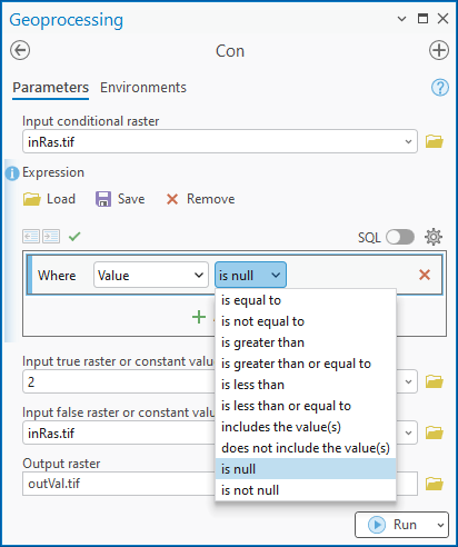

Workflow:
In the Con tool, do the following:
  1. Set the raster with NoData as the Input conditional raster.
  2. In the Expression, set the Where clause to Value and select the is null option from the list.
    This will use the Is Null tool internally to identify which input cells are NoData and which are not.
  3. Set the Input true raster or constant value to the replacement value you want to replace NoData cells with.
  4. Set the Input false raster or constant value to the original input raster, to preserve those values in the output.
  5. Set the Output raster location and name.
  6. Run the tool.
The following illustration shows the NoData locations replaced with the new value of 2, while the other locations retained their original value.
Replace NoData cells with a constant value
An example of replacing NoData cells with a constant value of 2.

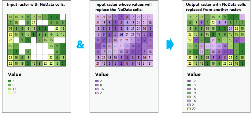

B: Replace NoData cells with values from a different raster
Instead of using a constant value, another raster can provide the values to replace NoData cells with.
If it makes logical sense to replace them all with cell values from another raster, there is no need to consider the size and distribution NoData areas. You can apply this method to both discrete and continuous data, but it is best to match the type of the replacement raster to the type of the raster you are updating.
Workflow:
  3. Set the Input true raster or constant value to the raster that the replacement values will come from.
  6. Run the tool.
Note:
If the raster providing the replacement values has different properties than the raster containing the NoData cells, such as extent, cell size, cell alignment, or coordinate system, remember to account for these differences. By default, the Con tool will use the union of the extents of the two input rasters, and the maximum cell size. To preserve the existing cell values that are not NoData and avoid them being resampled, be sure to set the Extent, Cell Size, and Snap raster environments to your original input raster.
The following illustration shows values from the other raster  replaced the other raster replaced the NoData locations, while the other locations retained their original value.
Replace NoData cells with values from another raster
An example of replacing NoData cells with values from another raster.

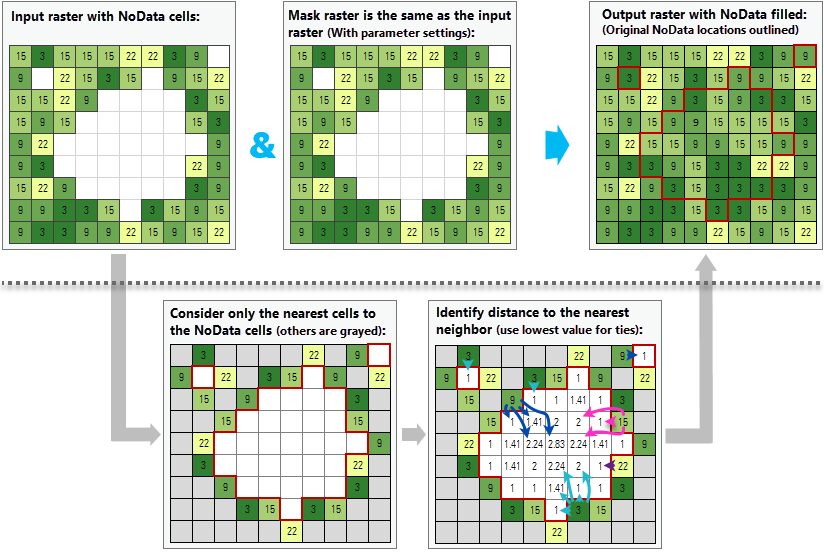

C: Replace NoData with the value of the nearest spatial neighbor
You may want to replace NoData cells with the value of the nearest (closest) cell. There is a tool that can do this: Nibble. It will replace the input values for a defined area with the closest value that is outside that area.
While the method can fill in large areas, it may be less logical for the replacement values to come from further away. Since the replacement values come from the same set of values as the input, this method is most suited to discrete data.
The Nibble tool has two required inputs. The first input is the raster for which the values at selected locations will be replaced with the nearest value. The second input is a mask that identifies what those locations are. For this input, NoData cells represent locations that are within the mask, and cells with any other value are outside the mask. There are two additional parameters that give specific control over how NoData cells are handled. By setting them a particular way, NoData cells in the input raster can also define the mask area. This means that you can use the same raster for both required inputs.
Workflow:
In the Nibble tool, do the following:
1. Set the raster containing NoData as the Input raster.
2. Set the same raster as the Input raster mask.
3. Set the Output raster to the location and name.
4. Uncheck the Use NoData values if they are the nearest neighbor parameter.
The objective here is to only consider cells with valid values to replace NoData cells.
5. Check the Nibble NoData cells parameter.
This will make the tool replace the NoData cells inside the masked area with the value of the nearest neighbor outside the masked area, instead of remaining as NoData.
6. Leave the Input zone raster parameter blank.
7. Run the tool.
The following illustration shows how the value of the nearest input cell replaces the NoData locations. To make comparison easier, a dark red outline on the output raster identifies the NoData locations of the input raster.
In the case of ties, where there are two or more input cells that are nearest to a NoData cell, the output will be the lowest of the tied values.  In the part of the figure below the dashed line, the numbers show the distance (in cell units) from each NoData cell to the nearest cell outside the mask. For a portion of the NoData cells, small arrows identify the specific input cell that provides the replacement value
Replace NoData cells with the value of the nearest neighbor
An example of replacing NoData cells with values from the nearest neighbor.

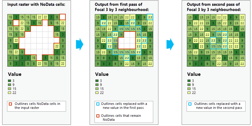

D: Replace NoData with a statistic calculated from the surrounding cells
A statistic calculated from the surrounding cells can replace a NoData cell.
This can be done by incorporating the neighborhood tool Focal Statistics into the analysis. For each input cell location, this tool calculates a statistic of the values within a specified neighborhood around it. You can specify a variety of neighborhood shapes, such as a rectangle, a circle, or a pie-shaped wedge, in whatever size you need. There are a variety of statistics to calculate, such as the average or minimum value.
The size of the areas of NoData is a consideration for this tool. For individual or small groups of NoData cells, the small default 3 by 3 cells neighborhood size can calculate the replacement value. To fill larger areas of NoData, either expand the size of the neighborhood, or run the process several times . For discrete data, the statistics that are most appropriate to use with this method are the maximum, minimum, most common, and least common. For continuous data, the mean statistic is typically the best one to use.
If run by itself, the Focal Statistics tool will calculate a statistic value for every cell in the input raster. To perform the calculations only on the NoData cells, we will apply the technique of using the Is Null tool within the Con tool to identify those locations. Then we will use the Focal Statistics tool to calculate a new value for those locations only.

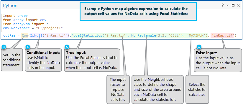

To embed this tool in Con, it is necessary to create a complex expression in map algebra. In ArcGIS Pro, this can be done in the Raster Calculator tool or in the Python Window.
Workflow:
Apply the following workflow to run the Focal Statistics tool in the Python window:
  1. Open the Python window and import the necessary modules.
  2. Set the workspace to where your data is located.
  3. Begin to enter the map algebra expression to construct the statement for the Con tool.
  4. For the Input conditional raster parameter, enter “IsNull()” and specify the name of your input raster.
  5. For the Input true or constant value parameter, specify the necessary syntax for the Focal Statistics tool to calculate the output for the neighborhood and statistic of choice.
    • Enter the name “FocalStatistics, without a space.
    • Set the Input raster to the raster you are processing.
    • Set the Neighborhood parameter the shape and size of the neighborhood around the NoData cells you want to calculate the statistic for.
    • Set the Statistics type parameter to the one you want to calculate.
  6. For the Input false or constant value, specify the original input raster again.
  7. Run the expression.
  8. As needed, set up and run the expression again to fill in large NoData areas.
  9. Since the result of the map algebra expression is a temporary raster object, use the Raster save method to persist the final output raster.
The following graphic shows an example of the syntax used to create a rectangular 3 by 3 cell focal neighborhood:
A map algebra expression that incorporates the Focal Statistics tool
An example of a map algebra expression in Python that incorporates the Focal Statistics tool.
Illustration:
The following illustration shows how values from input raster replaced the NoData locations with the maximum value in a 3 by 3 cell neighborhood around them . In this case, the size of the NoData area is larger than the size of the focal processing window. This would cause some of the NoData locations to remain as NoData in the output from the focal operation, since there were no input values to do a calculation for. To resolve this, you can run the operation again to replace the remaining NoData value, or use a larger neighborhood. This example ran the focal operation two times, with the output from the first pass used as input to the second.
Replace NoData cells with the value of a statistic from the surrounding cells
An example of replacing NoData cells with the maximum value of the nearest cells. For a 3 by 3 cell focal neighborhood, the size of the NoData area required two passes of the tool.
