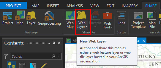

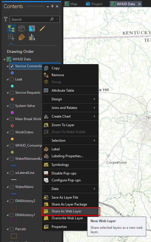

Publishing your data for use in Insights is a very familiar process, simply publish the data you want to consume from ArcGIS Pro into the Data Store on the portal that hosts Insights, that’s it!  Once the data is in your data store it is ready to use in Insights.  There are two main strategies for publishing your data:
  • Publish out multiple layers in one service from Pro for consumption in Insights (fig. 1).
  • Publish out individual layer is pro for consumption in Insights (fig. 2).
Fig. 1: Publishing Multiple Layers
Fig. 2: Publishing Individual Layers
Both strategies will allow your data to be consumed in Insights, but for related data and projects with many layers it may be beneficial to publish them out as a single or a couple of services.  This will cut down on your service load and make the backend administration a little bit more manageable.

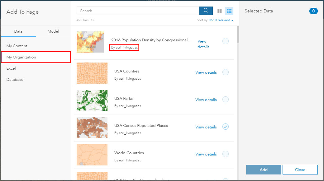

To add Geographies simply click on the Add Data button and select “My Organization” from the list of data sources, this will show all the Living Atlas geographies available to your organization (they will be authored by “esri_livingatlas”).
Living Atlas Geographies

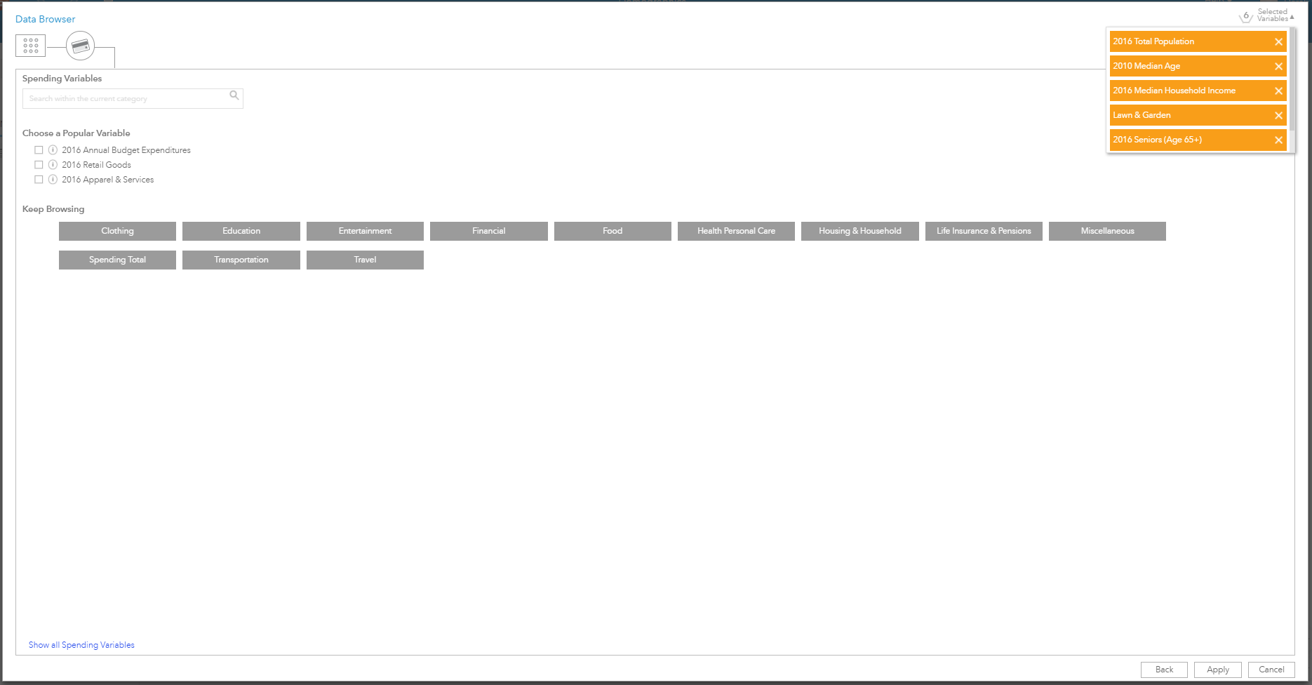

To enrich your data with information from the living atlas first click on the Action Button and select the “Enrich Data” tool, select the layer you would like to enrich and open the data browser.  In the data browser, you can navigate to one or many of the variables you would like to append to your dataset.  Spend some time exploring the data browser to get an idea of the depth of data available.  One of the most common datasets we used in our forums were focused on consumer spending habits to identify areas where residents may be amenable to rebate programs for appliances and reduction of irrigated land.  Once you have selected the variables you are interested in click the apply button and the variables will be appended onto the dataset you selected to be enriched.  From that point, you can create rich maps with this data or analyze it using the tools available in Insights.
Living Atlas Data Browser
