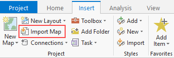

ArcGIS Pro is project-based. Each project has a single folder connection to your project’s home folder that includes the project file (.aprx) on disk. Inside this file are all your resources: maps, layouts, layers, tables, tasks, tools, connections to servers, databases, folders, and styles. When you decide to use Pro for your workflows, it’s important to know how to migrate your content. The first step to bringing your work from other ArcGIS applications into Pro is to create a project using the blank project template. Blank projects open without maps, scenes, or content. To bring your ArcMap, ArcGlobe, and Scenes into ArcGIS Pro, just click Import Map on the Insert tab.
Import Map

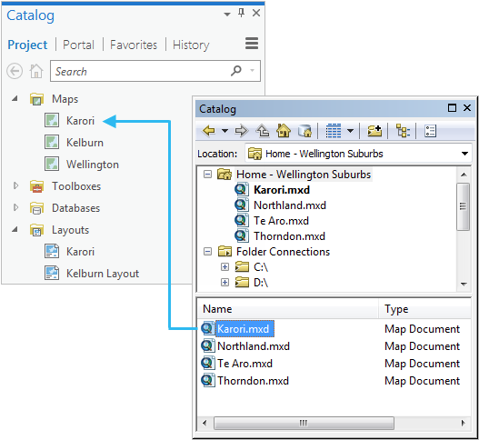

You can also drag and drop the map documents from the ArcMap Catalog window to the ArcGIS Pro Catalog pane or Catalog view.
Catalog in ArcMap and ArcGIS Pro
When you import a map document (.mxd), each data frame is imported as a separate map. Map layers are imported with their symbology, layer properties, and metadata. After the import process is complete, you can view, open, and manage the imported content in the Catalog pane.
