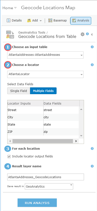

To get started with Geocode Locations from Table, all you need are the addresses you want to locate and a locator (parameters 1 and 2 outlined in red). A quick note on locators– they can be configured specifically to your location and data, or they can be geared towards a larger audience with various location formats. It is up to your organization to decide what you would like to use! Let’s have a look at the interface that guides your geocoding journey with an Atlanta example:

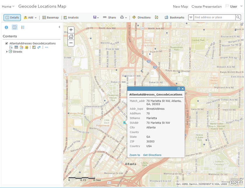

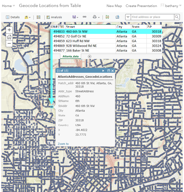

Once you have provided the input table and locator parameters, you are able to run the tool and see your results.
And voila! By placing your locations on a map via Geocode Locations from Table, you have initiated the process of data exploration for you and your organization. Now that we have eliminated the fear of GeoAnalytics and big data, get out there and geocode!
