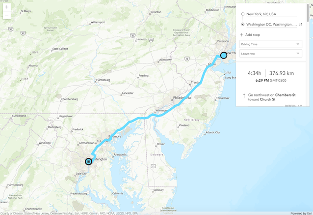

Directions Widget (Beta)
If you’re taking a trip to parts unknown, then the Directions widget is right for you. Currently in beta, this widget calculates directions between two or more locations and makes it easy to add turn-by-turn directions to a page as well as a route on a map. The widget defaults to the ArcGIS Online route service but can be configured to use any ArcGIS Server Network Analyst routing service. To explore further, see the Directions sample.

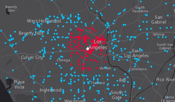

Support for Geometry Operations in Arcade with 3.23
Arcade expressions now support geometry operations that allow you to perform overlay, proximity, topological relationship testing, and measurement operations. We added the Create a Geofence with Arcade sample to demonstrate how you can drive visualization based on on-the-fly geometric operations; in this case when city buses enter the downtown LA area.
