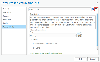

In ArcGIS Pro 1.4 or later, open the network dataset layer properties, and click the Travel Modes section on the bottom.

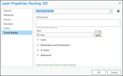

To create a new travel mode, click the burger menu in the top right, and then New. You’ll see some fields for your new travel mode in the dialog.
Give the travel mode a name and description that will inform your workers what type of travel it’s meant for. For example, you could name this travel mode “Trucking Height Restriction” and give it the description “Use this travel mode to avoid roads with low bridges while driving a tall truck.”

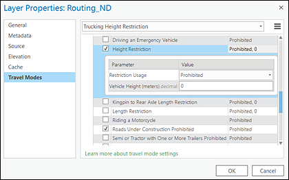

Then, set the rules for the travel mode by specifying Type and Restrictions and Parameters. For Type, set the transportation method that this mode is intended for: trucking. To set Restrictions and Parameters, first expand this section. A list of travel mode attributes that you can adjust appears. Which attributes you see depends on the attributes of your network dataset. The StreetMap Premium network dataset includes the Height Restriction attribute. Check the box next to this attribute and select it. Two fields appear under the attribute: Restriction Usage and Vehicle Height.
Restriction Usage indicates whether the value of an attribute should be prohibited, avoided, or preferred. Since you never want a truck to go on a road with an overpass that is lower than the truck, set Restriction Usage to “Prohibited.”
For Vehicle Height, say your workers’ trucks are about 14.5 feet. Enter 4.4 for this parameter, since all Restrictions and Parameters are in terms of meters for StreetMap Premium. When you are finished, click OK, and there you have it: a custom travel mode that allows your drivers to avoid roads with low clearances.
