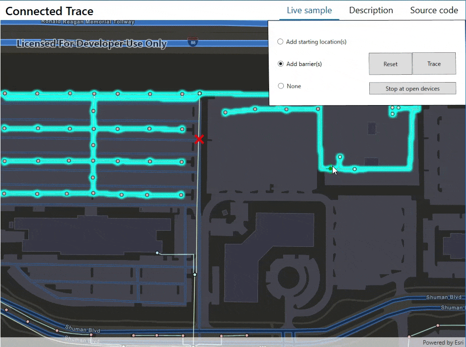

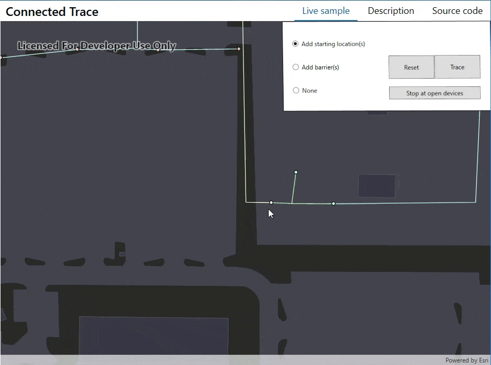

The following series of gifs, is a demo of the connected trace authored with ArcGIS Runtime on .NET
In this animated gif, we place a starting point on a line and you can see that we detect where exactly we clicked on the line, then we place a barrier on another line and then run a connected trace.
Utility network connected trace
Utility network connected trace start from line

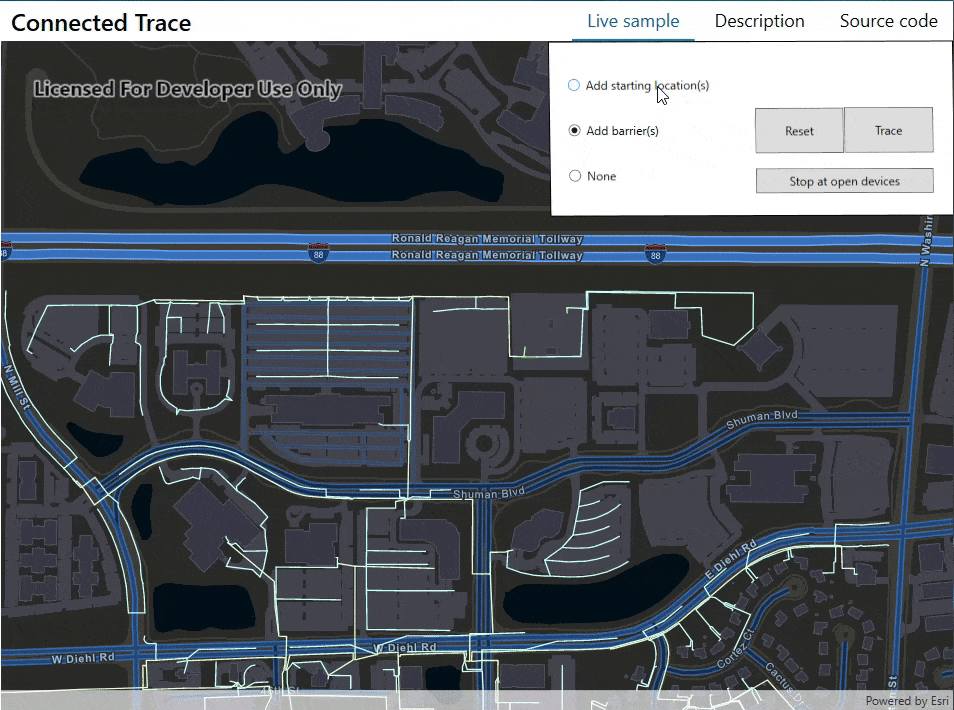

In this animated gif, we place a starting point on a device that has multiple terminals (Source and Load) and we actually place the starting point on the load side. We place a barrier on a line feature and run the trace. Notice that we are getting upstream result, this is something we will fix next.
Learn more about terminals here.
utility network connected trace
utility network connected trace start from a terminal
In this animated gif, we prevent upstream features from being selected by placing a barrier on the source side terminal so the trace doesn’t select the substation features.
Utility Network connected trace stop at terminal
