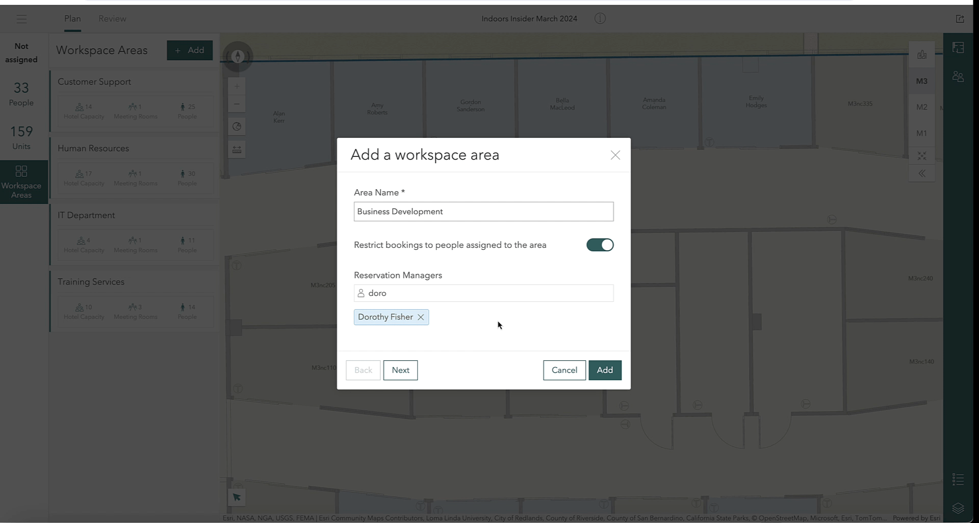

This release introduces Workspace Areas, which allow you to manage all your reservable workspaces in one place. This way, you only create the area once and add all types of reservable spaces, assign a reservation manager and occupants, and set scheduling limits to ensure space utilization is as intended. This also eliminates the need to manually sync the occupant assignments across different types of workspaces and reservation managers can now administer bookings for both office hotels and meeting rooms in the assigned workspace areas
ArcGIS Indoors space planner - add a workspace area popup windor on indoor map

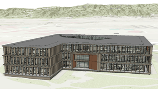

– Import 3D features from IFC. The Import IFC To Indoor Dataset tool, initially released at ArcGIS Pro 3.2 to support loading 2D floorplans from IFC, now also supports importing 3D features.
As with the Import BIM To Indoor Dataset tool, this support includes importing a subset of 3D multipatch features from the IFC model for rich visualization in floor-aware scenes.
3D model of a building on a map

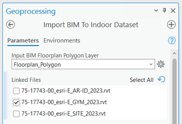

– Support for importing linked models from Revit. As Revit models can get large when several teams work on different aspects, such as different parts of a large building, or different disciplines, such as electrical, mechanical, structural, linking multiple Revit models for the same building is a common practice. You can now use the Import BIM To Indoor Dataset tool to import linked Revit models along with the main model to the Indoors workspace.
Geoprocessing Tool - Import BIM To Indoor Dataset

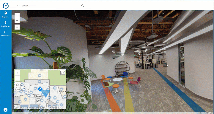

This release introduces a new tool called Import Indoor Images, that allows you to import photos from .e57 files to an oriented imagery dataset. It populates the Level ID based on the vertical and horizontal overlap of the photos with the levels features in your Indoors workspace. This new tool provides foundational support for the photo reality experience we’re developing for the Indoors web and mobile apps.
Along with the Import Indoor Images tool, we’ve added support for configuring oriented imagery layers as floor-aware. Once you’ve imported your images to an oriented imagery layer using Import Indoor Images, you can explore and visualize those photos using the oriented imagery viewer in Map Viewer on ArcGIS Online and ArcGIS Enterprise.
360 degree image of an office
360-degree photo in default image viewer
360-degree photo in the Oriented Imagery viewer on ArcGIS Online

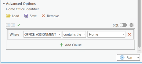

– The Update Occupant Features tool now supports specifying workspace occupants’ status as “work from home”. This is already supported in Indoors Space Planner, but if you manage this information in your HR system, you can now also use ArcGIS Pro workflows to add and update this information. You can create occupant features with a work from home assignment when you first load data to the Occupants layer, and periodically run it against the HR data to keep the Indoors model up to date with employee changes.
home office identifier
