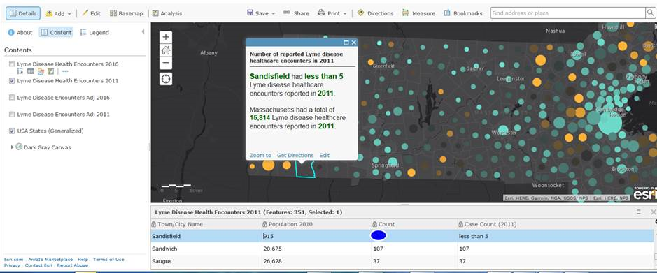

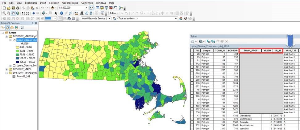

Go back to the original source of your data (or export it from ArcGIS Online as a shapefile if it’s shared publicly), and work in either ArcGIS Desktop or Pro. Add a field with field type = text. When calculating the field, use the original data field(s) along with any suppression rules as your logic. For example, the layer and attribute table in the screenshot below show the count of Lyme Disease per township in 2016. The count is in the field named YR2016 and the new text field is named YR16_TXT. For those townships with fewer than 50,000 in population, and a count under 5 (field YR2016), the value of the new text field will be “less than 5”, otherwise, the value will be the original count:
Remove the original field, then save, export data, save in a geodatabase, and publish this new layer to your ArcGIS Online account, and use this new display field for your pop-up needs. The screenshot below shows the township of Sandisfield with a suppressed count in 2011:

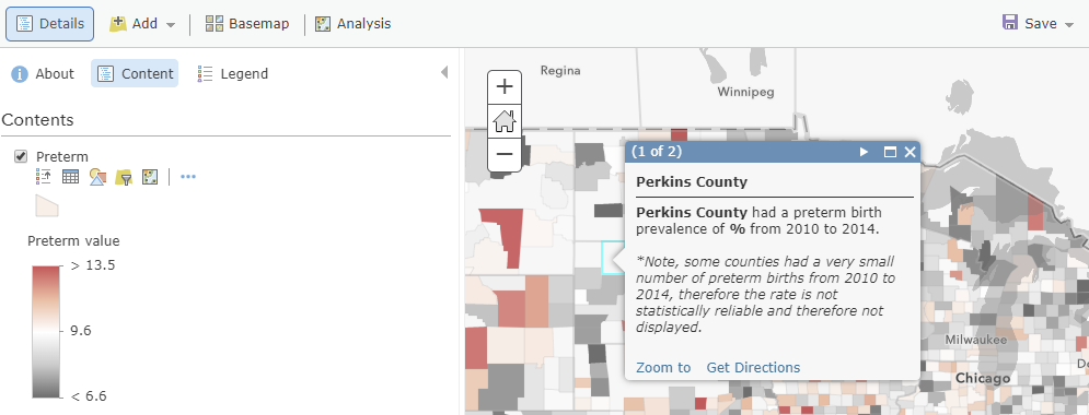

Other times, GIS analysts are not working with the source data directly, but with a data set from some other agency that has already suppressed the low counts. For example, I have a layer of the rate of preterm births (defined as births before 37 weeks of gestational age) by county from 2010-2014. I downloaded this data from a government FTP site (Centers for Disease Control and Prevention’s Health Indicators Warehouse, formerly healthindicators.gov). The downloadable data already had null values if the county had a “low count” of preterm births, too small of a count to yield a statistically reliable rate. Before Arcade expressions came along in ArcGIS Online earlier this year, I added a footnote to my pop-ups to explain the null values:
Now, I can do conditional text in the pop-ups using Arcade expressions. Arcade expressions takes your layer’s tabular data that needs just a few more calculations and allows you to dynamically symbolize the data in your map and to display any data or text in your pop-ups the way you want to. If the county does have a valid rate, then I can display my original sentence. If it has a null value, I can display a new sentence stating what the footnote says.

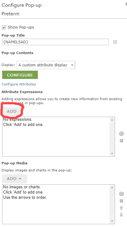

How, you ask? On the layer in the Table of Contents side panel, I click the three dots right underneath the layer name to display More Options -> Configure Pop-Up. In the Configure Pop-Up dialogue panel that comes up, I change the contents to “A custom attribute display.” Then, I’ll click the Add button under Attribute Expressions:

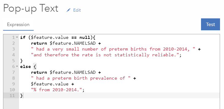

An Expression Box appears. I’ll first change the word “Custom” to the name of this new variable that I’m creating on the fly: “Pop-up Text.” In the Expression Box, I type simple Arcade syntax to apply any if/then logic or other customized steps. The Globals are all the fields that exist in your attribute table, and the functions are common scripting functions (for numeric data, functions that you could find on a scientific calculator and then some; for character data and date/time data, there are additional Arcade functions available). If there were any previous expressions created for this layer (say for symbology or labeling), there would be an Existing tab in addition to Globals and Fuctions so that these previous expressions would be available for use.

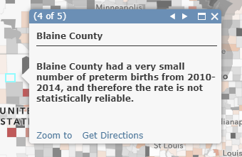

Recall that I want to display a simple sentence if the rate is valid: “{County} had a preterm birth prevalence of {value}% from 2010 to 2014.” If there’s no valid rate, then I’ll say what I said in the footnote: “{County} had a very small number of preterm births from 2010-2014, and therefore the rate is not statistically reliable.” Here’s what this looks like in my Pop-up Text expression:

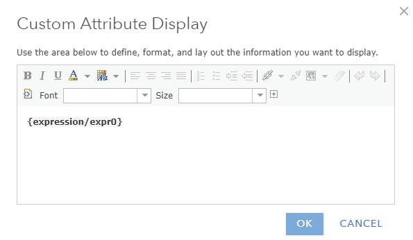

I can then click the Test button to make sure I don’t have any syntax errors, then click OK. Once I have this, I can now configure my pop-ups using a Custom Display to show our sentence above. I’ll build it in the Custom Attribute Display window like this using that plus sign to add field names. Scroll down, as expressions are added at the very end of the list of attributes:

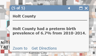

My beautiful pop-ups now display the correct sentence based on whether or not the rate was suppressed in the data I was able to download. For example,
vs.
