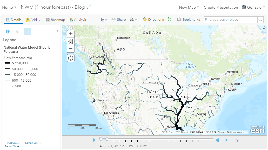

Creating a web map

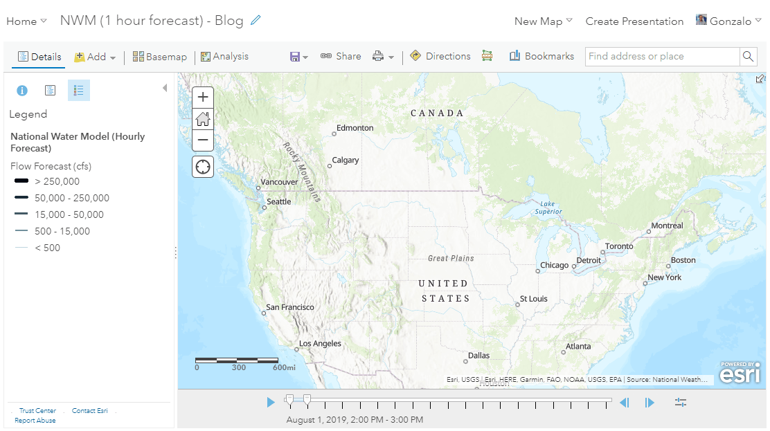

The NWM (1 hour forecast) web map includes the National Water Model (Hourly Forecast) time-enabled layer from Living Atlas. The web map was created and saved on August 01, 2019 2:00 pm PST. The map displays the right forecast from 08/01/2019 2:00 pm to 02/02/2019 7:00 am PST.

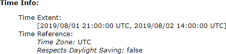

The National Water Model (hourly forecast) displays the same time extent in its REST endpoint, from 08/01/2019 9:00 pm to 02/02/2019 9:00 pm UTC.

An hour later, we viewed the map after the National Water Model (hourly forecast) layer automatically updated using its feed routine. The REST endpoint now shows the forecast time advanced 1 hour, from 08/01/2019 9:00 pm to 02/02/2019 9:00 pm UTC.
However, the start time on the web map still shows one hour behind so the map does not display the latest forecast.
We fix this issue by removing the time extent properties of the web map, forcing it to retrieve the time extent from the National Water Model (hourly forecast) layer when the map is reloaded.

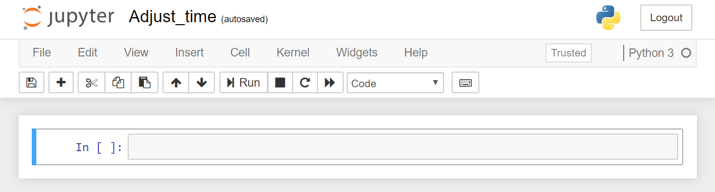

Open an ArcGIS Notebook in ArcGIS Enterprise or in your desktop.

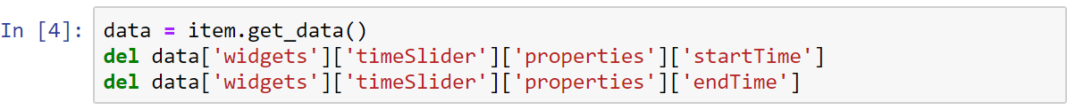

Get the web map item data as a dictionary and delete the ‘startTime’ and the ‘endTime’ properties of the time slider widget.
Note: If your time-enabled layer has a fixed ‘startTime’ and data is appended at the end (i.e., moving ‘endTime’), you can remove only the ‘endTime’ property on the time slider and allow the web map to discover it automatically from the time-enabled layer.

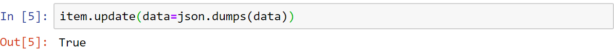

Update the web map item details.

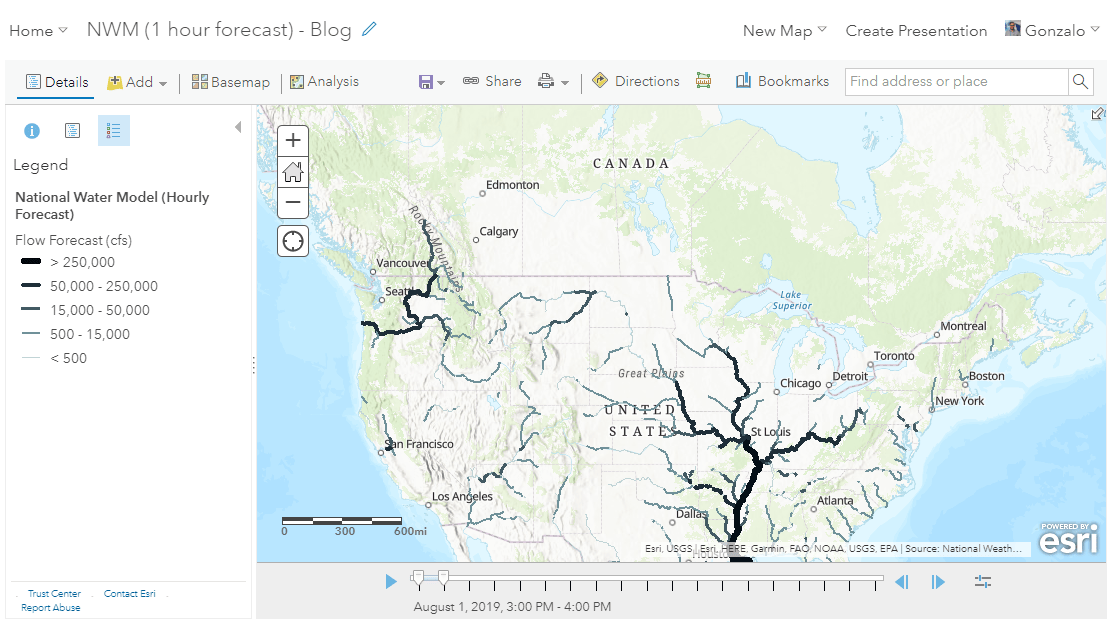

Now the NWM (1 hour forecast) web map displays the correct time extent after it’s refreshed on the webpage.
After updating the time slider settings, the ‘startTime’ and ‘endTime’ properties are blank (i.e., the values are no longer hard-coded). The web map will query for the time extent settings from the time-enabled layer when the web map is loaded.
